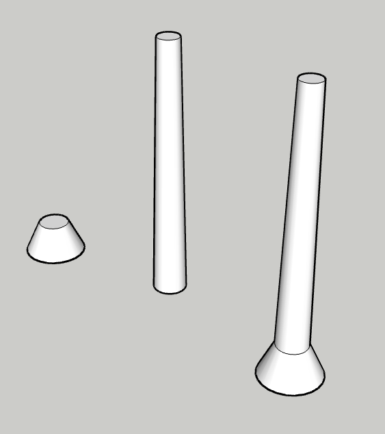

ReMark Posted November 21, 2022 Share Posted November 21, 2022 (edited) Looks like a fun project to tackle. If I still had full AutoCAD on my computer I could probably walk you through it but doing it using just typed instructions would be a bit of a chore but here are some basic ideas. Judging by the image I see that this is an attachment for an electric toothbrush. As David (i.e. - CADTutor) has indicated the use of the LOFT command would aid in the construction of your 3D model. For example, starting at the very bottom two circles, one larger than the other (the bottom) would be lofted to produce the required shape (a truncated cone). I suggest you look at the instructions for the LOFT command both in your AutoCAD for Dummies book and in the AutoCAD Help file. The same command could be used to create the bulk of the handle above the truncated cone. The portion of the toothbrush head that holds the bristles could be created using the LOFT or EXTRUDE command. The tricky part is the point at which the head attaches to the handle. This needs to be a smooth transition as you are going from a round shape (the handle) to a flat shape (the head). The bristles can be created using the EXTRUDE or PUSHPULL command. I would made one set of bristles, then copy them to create the rows which appear to have 2, 3 and 4 sets of bristles. Once you have them in place they could be shaped (higher at each end and the middle) via the SLICE command. Again, you will have to consult your book and/or the Help file to learn how to use this command. BTW... there are tons of AutoCAD videos on the Internet. Any command you can think of has been demonstrated by someone at one time or another. Good luck with your project. BTW... do you have the actual toothbrush from which you can take rough measurements? Edited November 21, 2022 by ReMark Quote Link to comment Share on other sites More sharing options...
ReMark Posted November 21, 2022 Share Posted November 21, 2022 (edited) What you see below was created in a program called Sketchup, a 3D modeling program. It basically demonstrates what I was talking about using the LOFT command, in AutoCAD, with two different size circles. I created the truncated cone base first followed by the shaft (using same technique) second. I created each part separately, although that isn't absolutely necessary, then moved the truncated cone to the bottom of the shaft making use of the Center Osnap. Are you familiar with Osnaps and the various settings? When every component has been created and you are satisfied with the result you can elect to UNION (join together as one entity) the individual parts if you so desire. This should really be done only as a final step. Edited November 21, 2022 by ReMark Quote Link to comment Share on other sites More sharing options...
davenutron Posted November 21, 2022 Author Share Posted November 21, 2022 Hi there, I have a problem already, I go to make the loft command with 2 circles, 1 being higher on the z axis. What I do is froma tutorial, select both circles press enter. He on the video says select cross sections I presume he means cross sections only as thats all I have. It says the selcted entities are not valid. Any idea what is going on here. Quote Link to comment Share on other sites More sharing options...
ReMark Posted November 21, 2022 Share Posted November 21, 2022 Lofting two circles should be as effortless as blinking one's eyes. Draw a 2D circle. Next, draw a vertical line in the Z axis. Follow this by drawing a second 2D circle, with a smaller diameter at the top of this line. Invoke the LOFT command then select the bottom circle followed by the top circle. Finally, press Enter when done. In the example shown above my bottom circle had a radius of 0.1875. The top circle had a radius of .09375. The vertical line (in Z axis) had a length of 0.25. BTW... are you working in a 3D modeling environment? If so, it might be useful to work in the SE (Southeast) isometric view. Quote Link to comment Share on other sites More sharing options...

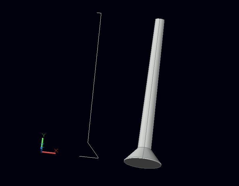

Cad64 Posted November 22, 2022 Share Posted November 22, 2022 Another approach that might be easier for a beginner would be to draw half the profile and then revolve it. 1 Quote Link to comment Share on other sites More sharing options...

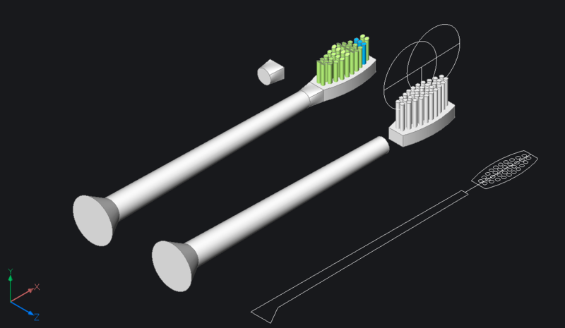

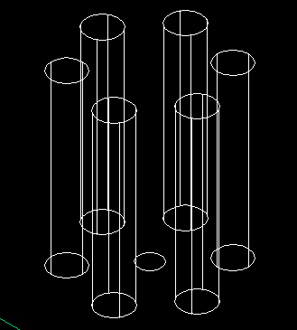

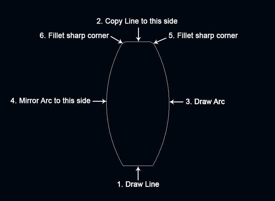

Cad64 Posted November 22, 2022 Share Posted November 22, 2022 Ok, here's my toothbrush. It took about 30 minutes. It's all pretty straightforward modeling operations. The only tricky part was the transition piece connecting the head to the shaft. For the shaft, I drew the profile and Revolved it. For the head, I drew the outline and then extruded it up a little. Then I put a Fillet radius around the bottom edge. Then I Mirrored it and Unioned both pieces together. For the brush, I just created a bunch of cylinders and arranged them on the head. Then I Unioned them all together. Then I created the two large cylinders and subtracted them from the brush cylinders. The transition piece was tricky, like I said, but I was able to create it with a Loft. The only problem is the Loft creates a surface, not a solid, and Autocad refuses to convert the surface to a solid, so the head, the shaft and the transition piece are all separate parts. I don't know if any of that helps, but give it a try and see how far you can get. By the way, I have moved this thread to the Autocad 3D Modeling section: https://www.cadtutor.net/forum/forum/14-autocad-3d-modelling-amp-rendering/ 2 Quote Link to comment Share on other sites More sharing options...

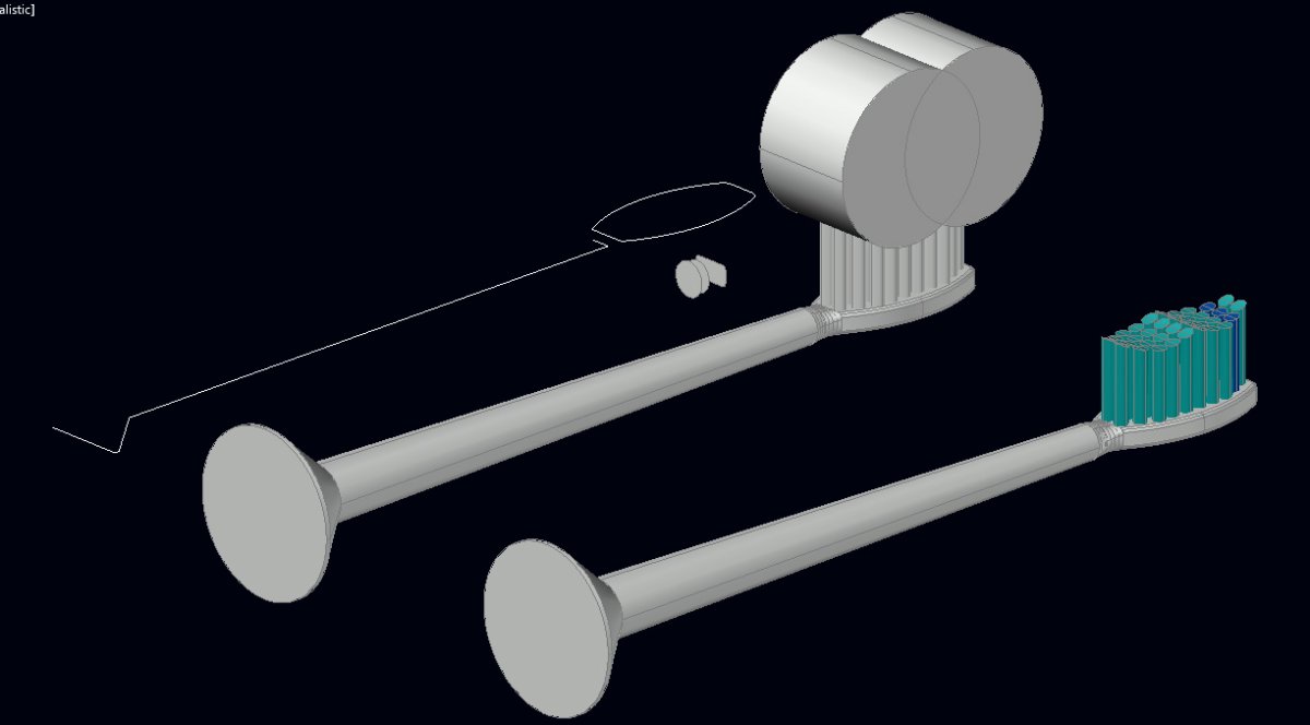

Cad64 Posted November 22, 2022 Share Posted November 22, 2022 1 hour ago, davenutron said: I have worked out why I got error code both circless were on the same value on the z axis. Now I need to know how to line out the part of the head with bristles on. It sounds like you're trying to run before you even know how to walk. You're jumping into 3D without any knowledge of how to draw simple shapes in 2D. You should look for some tutorials on Youtube to learn the basics of drawing in 2D. Below is an illustration to show how I created the brush head. After you draw all the lines and arcs, you can use the PEDIT command to join all the lines and arcs into a single Polyline. Once you have the Polyline, you can EXTRUDE it to create the 3DSolid. Question: If you're a beginner, why do you have a deadline? Is this a school project? 1 Quote Link to comment Share on other sites More sharing options...
davenutron Posted November 22, 2022 Author Share Posted November 22, 2022 The problem I have encountered is when I make a line from the bottom to the top horisontal line on your diagram in order to give me snaps the botton snap does not work and also the middle of the arc is not snapped how should I do the arcs evenly, ~I have tried a 5 sided polygon but that creates a larger round shape Quote Link to comment Share on other sites More sharing options...
Cad64 Posted November 22, 2022 Share Posted November 22, 2022 I'm sorry but I can't teach you how to use Autocad through messaging back and forth. I can only tell you the commands I used and the steps I took to create the various elements. It's up to you to take the information provided and use it to create your own objects. As I mentioned in my last post, you need to find some video tutorials to learn the basics of drawing in Autocad or take a class or find someone who can sit down with you and show you how to do these things. If you're having trouble drawing the Arc's, maybe you need to turn Ortho off by hitting the F8 key. I'm not sure what you mean by "snaps". Are you talking about Osnaps? If you draw the elements, in the order I noted, you should be able to start the Arc at the endpoint of the bottom line, then click a point in space for the 2nd point of the arc, (you can adjust the curve later), then end the Arc at the endpoint of the top line. Make sure your Osnaps are enabled by hitting the F3 key, before you start drawing the arc. You may also need to adjust your Osnap settings to make sure you can snap to Endpoints. The image below shows the settings I have set as default. You can access the settings dialog by typing OSNAP at the command prompt. Quote Link to comment Share on other sites More sharing options...
