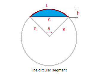

This is a bit different than the lisp ronjonp linked. instead of degrees it uses a minimum length to generate points. It will always divide an arc into 5 equal segments or if the arc can be divided more then 5 by the minimum distance the higher division will be used.
the larger outline went from 52 vertices to 656. see example.
Apparently you can test for bluge with visual lisp (seen in lisp ronjonp linked). So it make the code a lot simpler. no longer have to explode the polyline.
Again thank you @Sambo for pointing out the errors my earlier lisp was making.
;; ssget "WP" doesn't work well with polylines with arcs. This fixes it.
