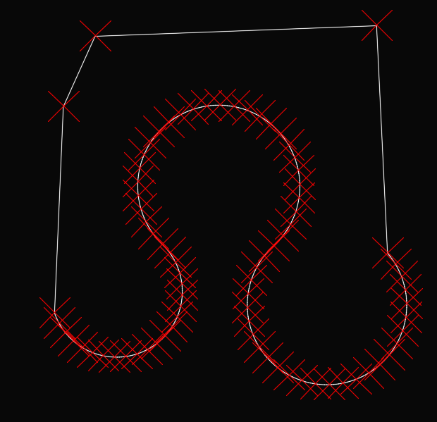

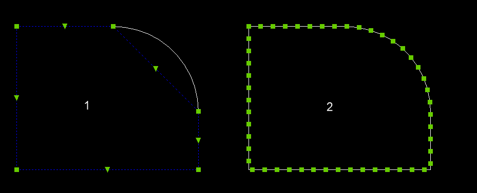

So the 100 is saying divide up the polyline into 100 segments and generate points from that.
poly 1 has 5 points and wouldn't select anything between the blue and white
poly 2 has 50 points (selectinside e 50)
If you are using this on polylines that have a large number of verities then their will be gaps. don't get me wrong iv used that form lee mac for a long time and didn't under stand what it was doing also. But when I finally had time to study what it was doing I came up with this.

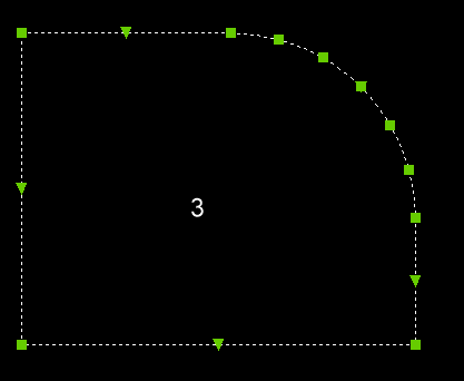

What my lisp does is makes a copy of the polyline and explodes it into its base entity's arcs and lines.
for the arcs its dividing them by x  and generates points. for lines it calculates the endpoints. adds all those points into a list for ssget "WP"
So the points on the shape would look like this.
Only adding 5 points if x=5 With larger verities polylines it only add points to where the arc's are. So you don't have to keep guessing the number for the function or generating more points for smaller polyines.
I would like to make x dynamic so it divides up larger arc more than smaller ones.
