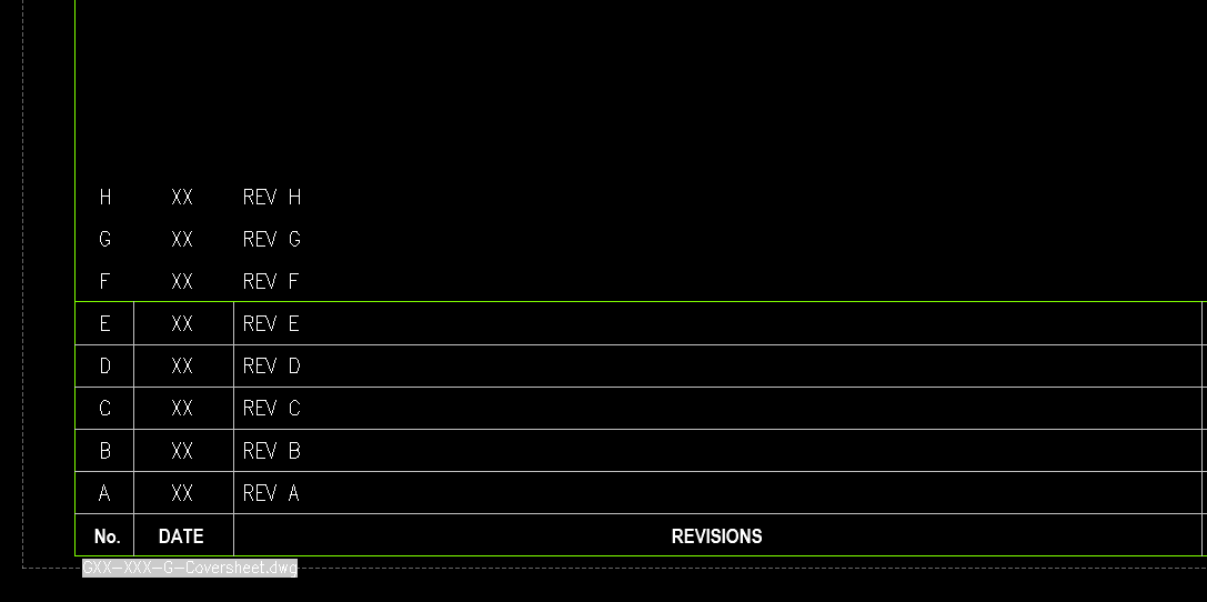

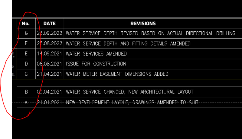

AGC Posted November 18, 2022 Share Posted November 18, 2022 Hi there I need some help please for the UTB lisp routine from Lee Mac. ( to update title block via excel sheet) Or perhaps point me in the right direction? I'm trying to learn to how write or modify lisp routines I'd like to create a lisp routine -or to modify the lisp routine I got- so that it looks for only the last 5 drawing revisions and uses those to populate the revision block in the DWG. I have used the UTB with great success, but have not been able to figure out how to automatically organize and clean up the revision block when we get more than 5 revisions (via the spreadsheet or the lisp). If anyone knows to to do that ,please just let me know, this would be a very valuable addition to our workflow. Thanks Amy Quote Link to comment Share on other sites More sharing options...

AGC Posted November 22, 2022 Author Share Posted November 22, 2022 Thanks for replying .. I've attached files ( excel sheet , dwg as an example ) in the screen shot, what I'm trying to achieve is : Rev H, G, F should go down and A,B,C should disappear ) Thanks Amy GXX-XXX-G-Coversheet.dwg TitleBlock and Drawing Register.xlsm UpdateTitleBlock.csv Quote Link to comment Share on other sites More sharing options...
BIGAL Posted November 22, 2022 Share Posted November 22, 2022 (edited) Ok I have and happy to provide what you want and yeah there is a BUT, the way it works is to take your title block revisions and organise them in row sequence. At moment it is a bit all over the place when looking for correct attribute. There is a very simple method when looking at block attributes that you get the attributes in a saved order so it is simple to just drop say the A row and replace with the next row a move down this makes the top row empty and can now be filled in. One of the features of bedit is that you can reorder the attributes so for me would have the revs filling in each row before moving onto next row when you edit the attributes. This is what I had in mind for filling in the atts by order. To edit the revs finding each tagname would be a big task as even the tag names are not similar, eg REV1 = A REV2 =B and so on could look for "REVX" if similar. So in finishing up if your happy to redo the attribute order then I can provide an answer to the cad part. "Move rev up when full.lsp" Should be able to do the excel bit direct (defun getrangexl2 ( / lst UR CR RADD ) a defun that lets you pick a range from excel which would be the new revision details picking relevant cells then updates CAD dwg. Edited November 22, 2022 by BIGAL Quote Link to comment Share on other sites More sharing options...
