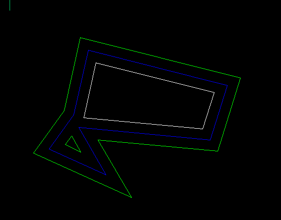

Offsetting weird shaped (blue) generates more then one entity when offsetting inside. The green is what would be deleted with (entlast) The white would be left over after running AH:chkcwccw
 This is what I came up with for Checking Direction. You should only feed this closed polylines because it wouldn't work with open polylines.
