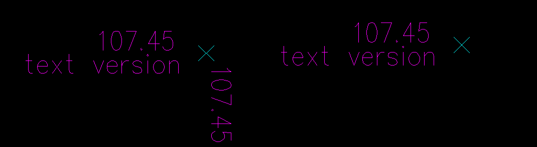

Thanks for the quick reply. I've attached a dwg with the blocks and text that we get to do this siting & grading work.
Basically that code I posted works like this, select an object text, if its text or mtext then select the point. if its a block with an attribute, use that then repeat for the next point. Then it draws a temp line between the 2 points.

If I understand correct you have 2 scenarios, a block with a "X" marks the spot and second a text say with a "X" but no attribute elevation value. Can you confirm please. Else if always the block then easy force look for block pick.
Hey Bigal,
Yes, you are correct, but technically there is 4 scenarios. Text then block, Text then text, block then text or block then block.
The idea is to be able to pick either or. Text then getpoint at X or the block and get insertion point at the X, then repeat for the second point.

Ok still dont understand if the block with the "X" exists then just reply "missed try again Please pick the "X" much more reliable than just pick anything you like, sometimes you have to educate the end user, provide more hints when asked to pick. As suggested to me a  4x2 works wonders when suggesting to a user to read the prompts.

So this is going to be used for siting and grading work in the residential industry.
We deal with different builders and therefore receive different files from the grading engineer.
Not all the Engineers use attributed blocks to do their point elevations. Some use the text/mtext with a block for the X.
