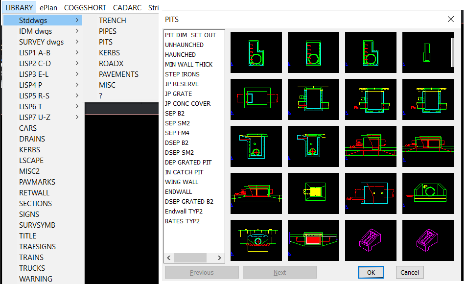

Split your blocks into logical categories and you dont need a lisp you can do it with a menu, the same with tool palettes group them. The menu has a next function built in, so if exceed 20 can go next screen.
Edited by BIGAL

BigAl it looks like rlx provided a nice routine for what the OP requested but I would use your method instead.  Grouping the blocks is a logical way to speed the selection process.  Just using a list of block names seems a bit tough. How can you remember what 100+ blocks look like?  I like the thumbnails your method provides.
all blocks are logos, wouldn't be able to break them down into groups otherwise i would have gone down this route. in future if i'm using blocks which don't have a good identifying name i'm going to break them into groups
Charpzy why not select logos via choose A or  B or C and so on that would significantly reduce the number to be displayed ? Like Rlx you can make like a 100 slides in one go using a script. There is just a little issue about screen resolution now but that is easy to get around. You can easily choose which set to use for me a menu or could do a dcl choose group.
Edited by BIGAL
