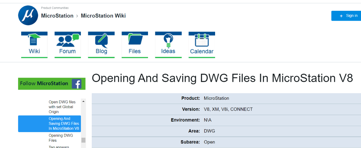

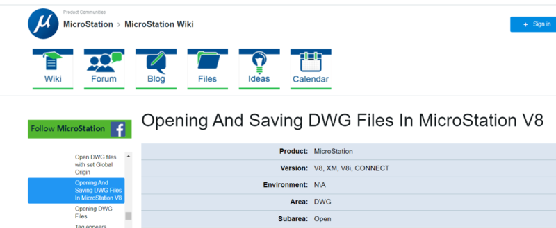

BIGAL Posted November 4, 2022 Share Posted November 4, 2022 Huh ! "hours/day for the DWG to be provided as well" I know nothing about microstation but export DWG is a command ! A 2 second google Quote Link to comment Share on other sites More sharing options...
