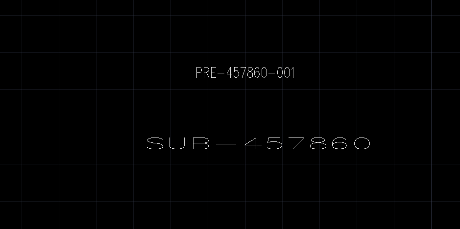

I use these two types of files...
within ABS-457860-001  there's a block reference named BLOCK1
within ABS-457875-001  there's a block reference named BLOCK2
I need the following:
1.- from the name of the file the code is taken  457860-001 (if it has another name it will be another code)
and join with "PRE-" in block reference.
2.- from the name of the file the code is taken  457860 (if it has another name it will be another code)
and join with "SUB-" in block reference.
be either name BLOCK1 or BLOCK2
the result inside the file would be like in the image...
ABS-457860-001.dwg ABS-457875-001.dwg
