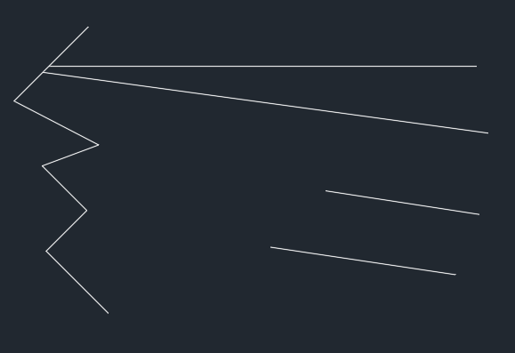

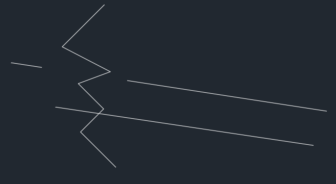

sketch11 Posted October 26, 2022 Posted October 26, 2022 For some reason TRIM and EXTEND do not intersect to lines. TRIMEXTENDMODE is 0, the traditional method. Example with EXTEND, only 2 of 4 lines extended. Example TRIM, one line subdivided, the other didn't trim. Quote

guran Posted October 26, 2022 Posted October 26, 2022 Are all your lines on the same plane (same Z coordinate) 1 Quote
sketch11 Posted October 26, 2022 Author Posted October 26, 2022 Yes they are. I've tested on several different files as well. Some setting must have changed and I don't know how to fix it. Quote

guran Posted October 26, 2022 Posted October 26, 2022 When I set EDGEMODE to zero it works fine. 1 Quote
sketch11 Posted October 26, 2022 Author Posted October 26, 2022 OK thanks for confirming. I did try again and it worked this time but I'm sure I tested before posting. Thanks for confirming, maybe it was my error. Quote
