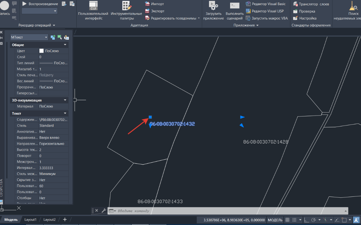

so there is a code that takes text / mtext and turns it into mleader. I want Lisp to take the first point automatically from the  mtext(I have shown in the screenshot below), and I want to specify the second point myself.
ronjonp didn't reply to my messages so I had to start a new thread. I myself have been trying to study the code for 2 weeks now, my thoughts are that it is necessary to somehow replace "pt1" in this code, but I don’t know how and with what.
