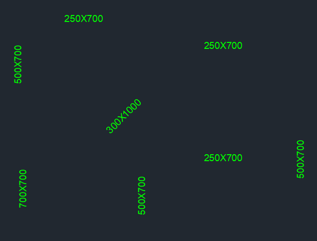

Hello Everyone,
I have some texts as following (the texts in blue), I want for all texts to remove the bracket "(" and any text before it, and also the bracket ")" and any text after it, so the result would be like the text in green.
Any one have lisp for that ?
Thanks in advance
image.png.b82368839f813ec437ddee13393f3703.pngnew block.dwg
Do all the texts follow the same formats as shown, for example all ending with ")", ")Inv.") or ") Inv." and all starting with "Bn(", which would make the LISP a bit easier - there is LISP find and replace out there which will work OK if you can specify the exact text you want changing (like regular find and replace but without the dialogue box).
If not will have to work out the texts to remove - which might be a shorter LISP and more versatile but I don't have that to copy and paste here.

Thank you for your reply, i am afraid it is not, i don't have certain format of texts each time, the things that will always be there is the "X" and the brackets
Hi, try this and let me know if it works for you

Thank you so much, this worked very well 😍
Here's another way assuming there are no spaces within the brackets.

Pretty cool way of reducing code of the selection, also your code has no need of entmod, I think there is only missing
