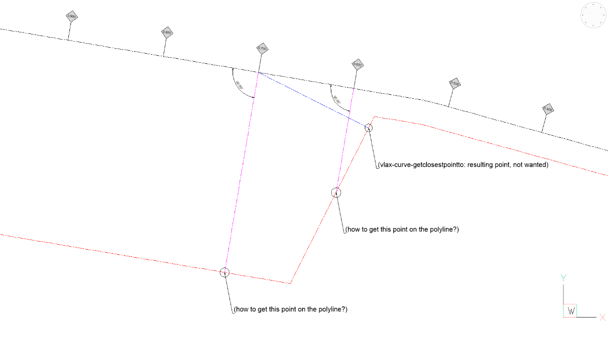

From a given point on a given (black line) polyline, I want to get the point on another polyline (red) perpendicular (magenta lines) from the polyline (black).
For most part of the red polyline, the getclosestpointto function will return the correct point:
 (setq ins_pt2 (vlax-curve-getclosestpointto poly1 ins_pt1))
But not where the red polyline changes its direction, then the blue line is the closest point, which is not what i want
In my main function I have already selected both polylines and calculated the point on the first polyline, so i only need a subfunction to calculate the point on the second polyline
any ideas how to solve this?

Here you go.
The idea is that the black route is a route where a Cable has to be buried by a trencher
The red route is the route that the Barge (which deploys the Trencher on top of the Cable) follows after the trencher is deployed
The point on the red route is where a dynamic block of the barge is inserted, but the KP of this barge is perpendicular/relative to the KP of the trencher at the Cable route

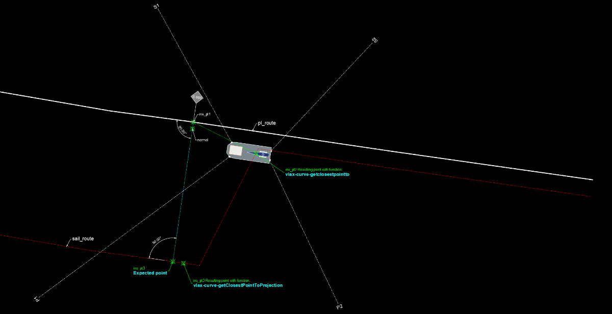

I have studied it can't figure out what goes wrong here with the vlax-curve-getclosestpointtoprojection function.
((/= ss2 nil)
		(setq intval (getreal "\nSpecify Barge Start Position by distance from Pipe or Cable Route at KP 0.0 (m): "))
		(while (> intval pl_leng )
				(setq intval (getreal "\nStart Position outside KP range, Specify Start Position by distance from Pipe or Cable Route at KP 0.0 (m) again: "))
		(setq ins_pt1 (vlax-curve-getPointAtDist pl_route intval))
		(setq param1 (vlax-curve-getParamAtPoint pl_route ins_pt1))
		(setq deriv1 (vlax-curve-getFirstDeriv pl_route param1))
		;(setq ang (- (angle '(0 0) deriv1) (* pi (/ 90 180.0)))) ; Variable just for testing
		(setq ang (+ (angle '(0 0) deriv1) (* pi (/ 90 180.0)))) ; Variable just for testing
		(setq normal (polar ins_pt1 ang 10)) ; Variable ust for testing
		(setq ins_pt2 (vlax-curve-getclosestpointto sail_route ins_pt1))
		(setq ins_pt3 (vlax-curve-getClosestPointToProjection sail_route ins_pt1 normal [extend])) ; Variable just for testing
		(setq sto_dist (rtos (distance ins_pt1 ins_pt2) 2 0))
		(setq ins_ang2 (atof (angtos (- (angle '(0 0) deriv1) (* pi (/ 90 180.0))) 0 2)))
		(alert (strcat "Selected Point is " sto_dist "m Stand-off from Pipeline or Cable Route at KP " (rtos (/ intval 1000) 2 3)))
The function is: (vlax-curve-getClosestPointToProjection curve-obj givenPnt normal [extend])
I have added a snippet of my code (see "Variable just for testing") and want to calculate ins_pt3
curve-obj = sail_route (red dashed line)
givenPnt = ins_pt1
normal = normal
Resulting location on sail_route is ins_pt3
The normal result is a coordinate extended 10 units from ins_pt1 with direction ang (for the function it doesn't matter on which side of the polyline the normal is calculated)
You can see in the picture that the ins_pt3 result is not an extension between the ins_pt1 and normal points
Note: the selected polylines may be curved or not, this case it is a non-curved object
What Am I doing wrong here?
