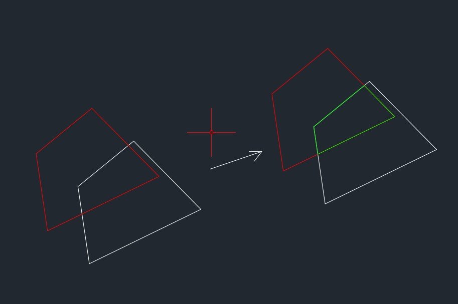

Guest Posted October 11, 2022 Share Posted October 11, 2022 Hi. I am searching for a lisp code to create boundary between 2 overlapping close polylines like the photo. I know that i can use bounady command but sometimes the drawing is not so clean and simple (must have hatch ot blocks , etc). I use for multi boundaries this code, but creates boundaries to all areas in the selection. In the example, you can see a red close polyline and a white close polyline. I want to select red and white polylines and create the green boundary in the overlapping area. (defun c:test ( / *error* big ent enx idx int lst pt1 pt2 rtn sel spc tmp tot val var vtx ) (defun *error* ( msg ) (foreach obj rtn (if (and (vlax-write-enabled-p obj) (not (vlax-erased-p obj))) (vla-delete obj) ) ) (mapcar 'setvar var val) (LM:endundo (LM:acdoc)) (if (not (wcmatch (strcase msg t) "*break,*cancel*,*exit*")) (princ (strcat "\nError: " msg)) ) (princ) ) (LM:startundo (LM:acdoc)) (cond ( (= 4 (logand 4 (cdr (assoc 70 (tblsearch "layer" (getvar 'clayer)))))) (princ "\nCurrent layer locked.") ) ( (setq sel (LM:ssget "\nSelect Lines or Polylines: " (list (list '(-4 . "<OR") '(0 . "LINE") '(-4 . "<AND") '(0 . "LWPOLYLINE") '(-4 . "<NOT") '(-4 . "<>") '(42 . 0.0) '(-4 . "NOT>") '(-4 . "AND>") '(-4 . "OR>") (if (= 1 (getvar 'cvport)) (cons 410 (getvar 'ctab)) '(410 . "Model") ) ) ) ) ) (setq spc (vlax-get-property (LM:acdoc) (if (= 1 (getvar 'cvport)) 'paperspace 'modelspace ) ) ) (repeat (setq idx (sslength sel)) (if (= "LINE" (cdr (assoc 0 (setq enx (entget (ssname sel (setq idx (1- idx)))))))) (setq lst (cons (list (cdr (assoc 10 enx)) (cdr (assoc 11 enx))) lst)) (setq vtx (mapcar 'cdr (vl-remove-if-not '(lambda ( x ) (= 10 (car x))) enx)) vtx (mapcar 'list vtx (if (= 1 (logand 1 (cdr (assoc 70 enx)))) (cons (last vtx) vtx) (cdr vtx))) lst (append vtx lst) ) ) ) (foreach pl1 lst (setq pt1 (car pl1) pt2 (cadr pl1) ) (foreach pl2 lst (if (and (not (equal pl1 pl2 1e-8)) (setq int (inters pt1 pt2 (car pl2) (cadr pl2))) (not (vl-member-if '(lambda ( pnt ) (equal pnt int 1e-8)) pl1)) ) (setq pl1 (cons int pl1)) ) ) (setq rtn (append (mapcar (function (lambda ( a b ) (vla-addline spc (vlax-3D-point a) (vlax-3D-point b) ) ) ) (setq pl1 (vl-sort pl1 (function (lambda ( a b ) (< (distance pt1 a) (distance pt1 b)) ) ) ) ) (cdr pl1) ) rtn ) ) ) (setq var '(cmdecho peditaccept) val (mapcar 'getvar var) tot 0.0 ) (mapcar 'setvar var '(0 1)) (foreach reg (vlax-invoke spc 'addregion rtn) (setq ent (entlast)) (command "_.pedit" "_m") (apply 'command (mapcar 'vlax-vla-object->ename (vlax-invoke reg 'explode))) (command "" "_j" "" "") (if (and (not (eq ent (setq ent (entlast)))) (= "LWPOLYLINE" (cdr (assoc 0 (entget ent)))) ) (progn (setq tmp (vlax-curve-getarea ent) tot (+ tot tmp) ) (if (< (car big) tmp) (setq big (list tmp ent)) ) ) ) (vla-delete reg) ) (if (equal (car big) (/ tot 2.0) 1e-3) ;; Gian Paolo Cattaneo (entdel (cadr big)) ) (foreach obj rtn (vla-delete obj)) (mapcar 'setvar var val) ) ) (LM:endundo (LM:acdoc)) (princ) ) ;; ssget - Lee Mac ;; A wrapper for the ssget function to permit the use of a custom selection prompt ;; msg - [str] selection prompt ;; arg - [lst] list of ssget arguments (defun LM:ssget ( msg arg / sel ) (princ msg) (setvar 'nomutt 1) (setq sel (vl-catch-all-apply 'ssget arg)) (setvar 'nomutt 0) (if (not (vl-catch-all-error-p sel)) sel) ) ;; Start Undo - Lee Mac ;; Opens an Undo Group. (defun LM:startundo ( doc ) (LM:endundo doc) (vla-startundomark doc) ) ;; End Undo - Lee Mac ;; Closes an Undo Group. (defun LM:endundo ( doc ) (while (= 8 (logand 8 (getvar 'undoctl))) (vla-endundomark doc) ) ) ;; Active Document - Lee Mac ;; Returns the VLA Active Document Object (defun LM:acdoc nil (eval (list 'defun 'LM:acdoc 'nil (vla-get-activedocument (vlax-get-acad-object)))) (LM:acdoc) ) (vl-load-com) (princ) Thanks Quote Link to comment Share on other sites More sharing options...

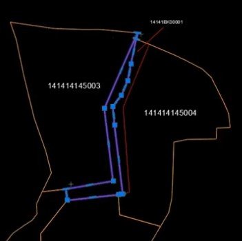

Guest Posted October 11, 2022 Share Posted October 11, 2022 Hi marko_ribar. I test your code but is not working correct. Check the test.dwg and you will understand test.dwg Quote Link to comment Share on other sites More sharing options...
Guest Posted October 11, 2022 Share Posted October 11, 2022 (edited) This is another example Edited October 11, 2022 by prodromosm Quote Link to comment Share on other sites More sharing options...
marko_ribar Posted October 11, 2022 Share Posted October 11, 2022 From you DWG : only upper blue polyline and magenata one below should work as there are only 2 intersecting points... Currently my routine doesn't support more than 2 int points, and beside be careful when picking polylines - you shouldn't pick at places where intersecting area is, but outer where open or closed curves have "so called - free endings"... Quote Link to comment Share on other sites More sharing options...
