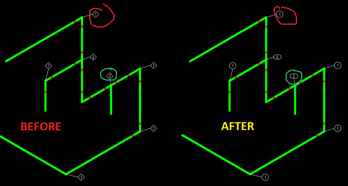

In my isometric drawing, I have many balloon. a shape balloon to show a note
for example
circle: Elbow
rectangular: Tee
end now I want to replace this shape  of balloon Untitled.thumb.png.14e4e604b9a77e33caee1689a508c8cd.pngwith click into an sample shape then sweept to choice block refence to replace.
You can see file that i attached and snapshot bellow
 Thank you in advane !
TEST.dwg
Easy if you use a dynamic block with multiple Visibility states.
Other way google replace block with new block. Multiple answers.
