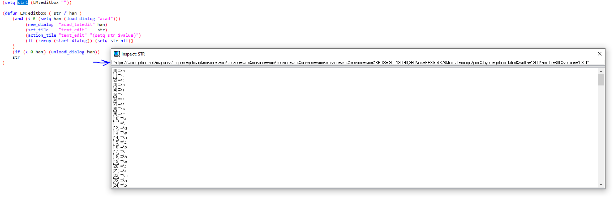

GetRemoteFile Method problem - doesn't download photo from long URL
Hey @lastknownuser,
Recently, about 3 months ago, I had the same problem when I'm inputing list of coordinates (not URL as in your situation), searched and find a Lee Mac "Edit Box", which allows you to input long strings. I had a list of coordinates which are above 256 chars.
This is the one example:

This is the link: https://www.lee-mac.com/editbox.html
  On 10/5/2022 at 12:53 PM, lastknownuser said:
https://www.gebco.net/data_and_products/gebco_web_services/web_map_service/mapserv?request=getmap&service=wms&service=wms&service=wms&service=wms&service=wms&service=wms&service=wms&BBOX=-90,-180,90,360&crs=EPSG:4326&format=image/jpeg&layers=gebco_latest&width=1200&height=600&version=1.3.0
Expand
When input your example (from quoted above), I get a full length of URL, which stored in str1 variable (picture 1).
Maybe this can also help you for your solution.
Best regards.

@Saxlle Thanks for the input, but the string variable length itself isn't the problem, its the GetRemoteFile not accepting URL string longer than 285. I can save the long string as variable normally without a problem if thats what you meant.
Expand
Yes, meant on that.
Give a try with this, one of solutions (it works on Windows OS):
