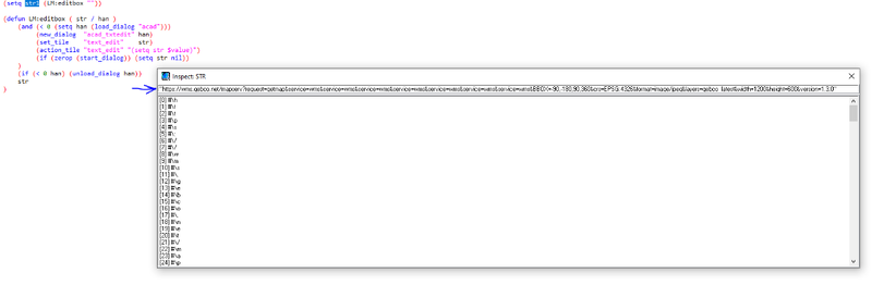

lastknownuser Posted October 5, 2022 Author Posted October 5, 2022 Here is a test URL, I made it longer by adding some duplicates: https://www.gebco.net/data_and_products/gebco_web_services/web_map_service/mapserv?request=getmap&service=wms&service=wms&service=wms&service=wms&service=wms&service=wms&service=wms&BBOX=-90,-180,90,360&crs=EPSG:4326&format=image/jpeg&layers=gebco_latest&width=1200&height=600&version=1.3.0 I noticed that 280 is the limit, everything beyong that gives me the mentioned error <!> Error Downloading File From URL <!> Quote

lastknownuser Posted October 5, 2022 Author Posted October 5, 2022 (edited) I'm running 64 bit, tested on 2 computers (Autocad 2018 and 2019). I am doing it that way, combining few strings to save url string as a variable, it is normally stored and can be seen if called. For last example strlen gave me value of 291. No spaces in url, it is just like the one, different parameters connected with "&" symbol. And it does not work. I tried to debug it as much as I could, but the error is always here, it gives T if url length is longer than 280 or something like that (vl-catch-all-error-p (vl-catch-all-apply 'vla-GetRemoteFile (list utilObj url 'tempPath :vlax-true)) ) EDIT: for strlen 285 I get nil, for 286 and up I get T, no matter on which side of "/" I add or remove characters. Edited October 5, 2022 by lastknownuser Quote
