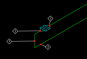

Trai Posted October 1, 2022 Share Posted October 1, 2022 Hi all, Recently, I have done many Isometric Drawings with many balloon numbers in Block Reference. Is there any way to Auto Numbering of text for that? Its same Tcount command. My idea is: 1. Using BURST command 2. Using Tcount. However it only allow user numbering via X, Y direction I have attached a example draiwng for test. So someone have way to resolve this issue. Thanks for the help. Test.dwg Quote Link to comment Share on other sites More sharing options...

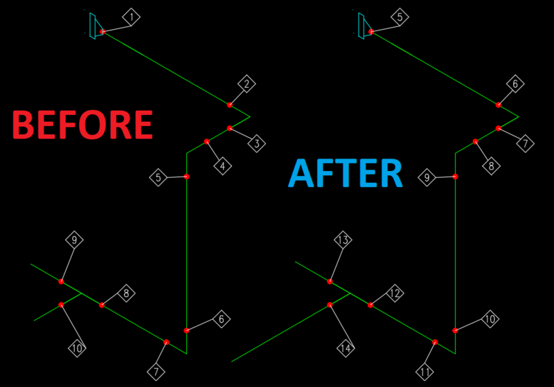

Trai Posted October 2, 2022 Author Share Posted October 2, 2022 as you can see this snap shot: number 1 (in left picture) will replace into 5 (right pictrure) number 2 (in left picture) will replace into 6 (right pictrure) number 3 (in left picture) will replace into 7 (right pictrure) etc... i will using BURST then use Tconnt command. but if i use Tcount conmand , The numbers only sort X, Y Direction Quote Link to comment Share on other sites More sharing options...

Trai Posted October 3, 2022 Author Share Posted October 3, 2022 @BIGAL yes, I have just test your lisp, it work, however all balloon replace with same number, you can see snap shot below. I wan to the balloon have number in ascending or descending. Quote Link to comment Share on other sites More sharing options...

Trai Posted October 3, 2022 Author Share Posted October 3, 2022 @BIGALyou can fixed code , I have just tested code that @marko_ribarrepaired. However the balloon still same number Quote Link to comment Share on other sites More sharing options...
