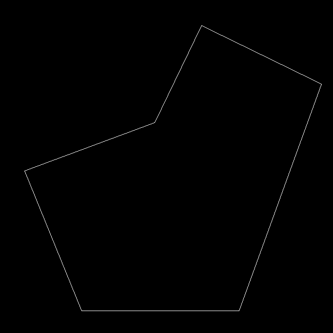

Irregular Polygon OA width & height
I looked but can't find a routine to get the TOTAL width and height of an irregular polygon?
That value can be put Into variable I can then use it.
I would also like to sore the X & Y locations of the extremity points.
Looking for the simplest routine...so I can understand it...lol
Any help would be great!
Thanks
This will give you the length and width of any selected entity
(defun C:foo (/ poly LL UR L&W) ;if you want to keeps these points for future use remove LL UR from this line.
  (setq poly (vlax-ename->vla-object (car (entsel "\nSelect Polyline")))) ;select entity and convert to vla-object
  (vla-GetBoundingBox poly 'LL 'UR)   ;use bounding box function to get lower left and upper right points (smallest horizontal rectangle)
  (setq LL (vlax-safearray->list LL)  ;convert to point
        UR (vlax-safearray->list UR)
        ;LR (list (car UR) (cadr LL)) ;if you need the other corners uncomment
        ;UL (list (car LL) (cadr UR))
        L&W (mapcar '- UR LL)         ;subtract UR from LL to get overall length and width of entity.
  (prompt (strcat "\nPoly Lenght:" (rtos (car L&W) 2 3) " Width:" (rtos (cadr L&W) 2 3))) ;displays lenght and width
Example: picked blue rectangle the white is representing the bounding box. If you want accurate dimensions make sure things are square.

Had a think about this and what if I am trying to fit on a rectang sheet of wood ?
So pick a side then UCS OB this would be used as sheet edge.
This code snippet gives world and current ucs points, can then work out X&Y max min. which in turn can get length and width.

@BIGAL I like it! works perfectly.
I've tried to find how to get min and max values from the co-ord2 list but can't.
There doesn't seem to be a simple way to find just the min/max X values?
What I plan on doing is dividing the overall width by a given/entered number then draw vertical lines over the polygon at those graduations, starting from the left most point.
I've learned enough to get that last part done, but the min/max I can't figure out
any help would be great,
Thanks
You need to look at the co-ords X & Y check is lowest is biggest.
I updated code above.
