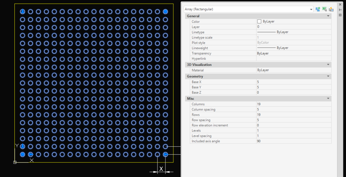

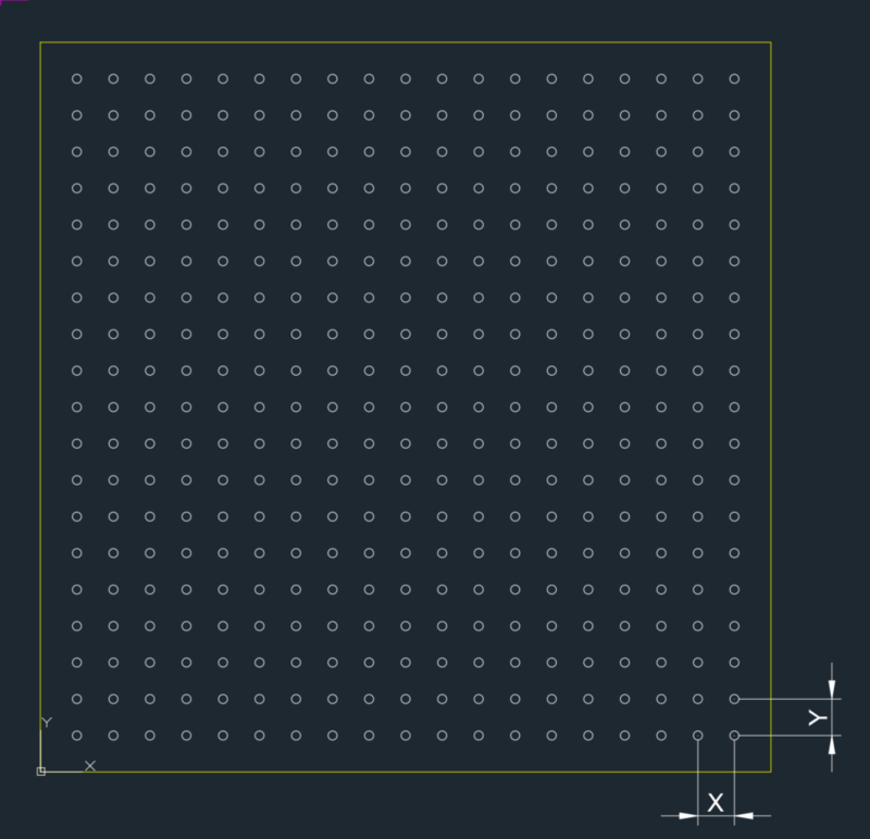

Can anyone help me, probably this question has already been answered but I didn't find it in my google searches.
How can I grid a point grid on a closed polyline by determining the X and Y distances.
$-Select polyline
$-distance X
$-distance Y
and it inserts the points inside the polyline. Similar to the attached image.
Note: Hatching does not work.
Like ronjonp its an Array answer and can be done very easy,  just enter X & Y spacing and a edge rule min gap. A lisp is required or get your calculator out, a pen and paper will be required.
Will it always be circles ?
Edited by BIGAL
Its not rocket science an example
L=100
Max offset = 10
X space = 7.5
100-2xoff = 80
80/ 7.5 = 10.666666
round up to 11
100-11*7.5 = 82.5
Xoff = (100-82.5)/2 = 8.75
So make a Array 11x11 using the lower left XY point eg 8.75,8.75

Ok the easy answer is get bounding box of shape pick a control point then array say your circle covering the complete area contained by the bounding box, then you get all the circles inside the pline put on another layer, isolate the original dummy layer and delete all circles. Turn on your circle layer and all done.
Yes I have something but need what it is you are really trying to end up with. Post a dwg
; POINTGRID - 2023.08.17 exceed
; https://www.cadtutor.net/forum/topic/76068-point-grid-by-selecting-polyline/?do=findComment&comment=622077
; Make point grid in closed polyline or circle.
; command : POINTGRID
; 1. Select objects to use as boundary.
; 2. Enter the x, y spacing gap value between each point.
; 3. If you want to give a margin to the inside of the boundary object, enter an offset value.
;    (Enter the space bar if not necessary.)
; This code modifies PDMODE and PDSIZE variable for visibility. you can modify it to you want.
(defun c:POINTGRID ( / ss x_gap y_gap base_offset ssl index ent obj minpt maxpt x_dist y_dist x_count y_count x_val y_val x_return pt_val judge point_output )

This command suggests creating an array specifying the step and quantity (not in staggered order).
This is easier to do in AutoCAD.
But I need to fill the contours with a staggered array, by type lisp POINTGRID @exceed...
