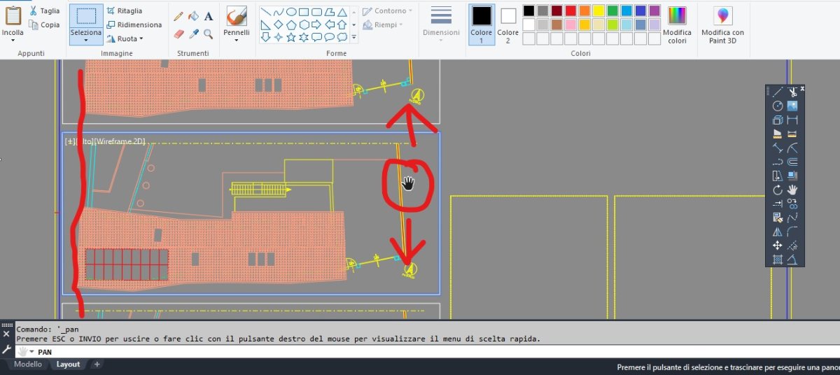

When I am in the loyout view, and I am inside a frame, with my hand how can I make the drawing go up or down, constraining the straight up and down, so that I have all the drawings aligned?
Thank you

No, that's not good, in this way the drawing becomes in 3D

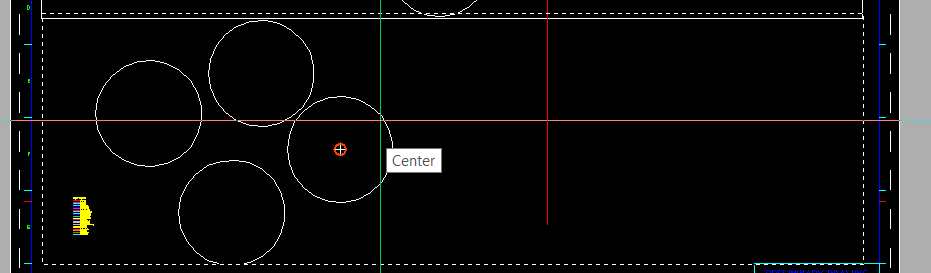

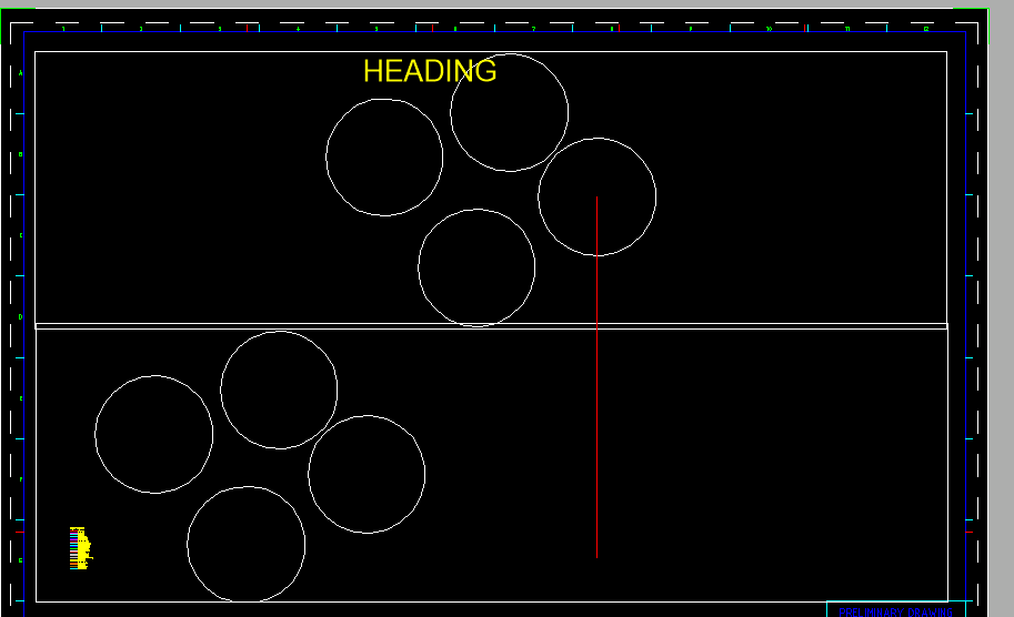

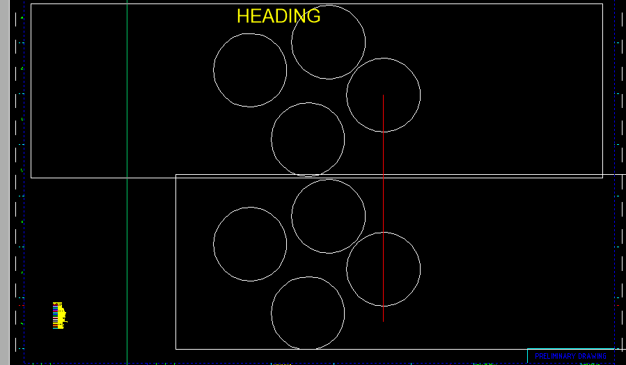

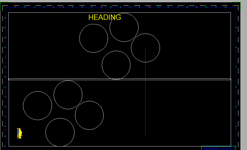

This is a way of doing it be in paperspace draw say a vertical or horizontal  line from an object point. Crossing second viewport. Do move,  select 2nd viewport, pick object pt in mspace but stay in paperspace, use Perp option to line the view port will be lined up now can adjust viewport edges using same technique.
