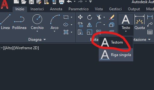

Giovannino60 Posted September 23, 2022 Posted September 23, 2022 When I select the text, it is immediately set rotated how do I set it forever straight? Thank you Quote

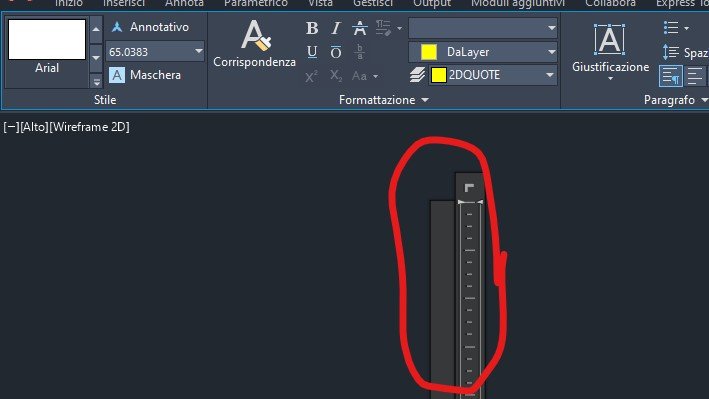

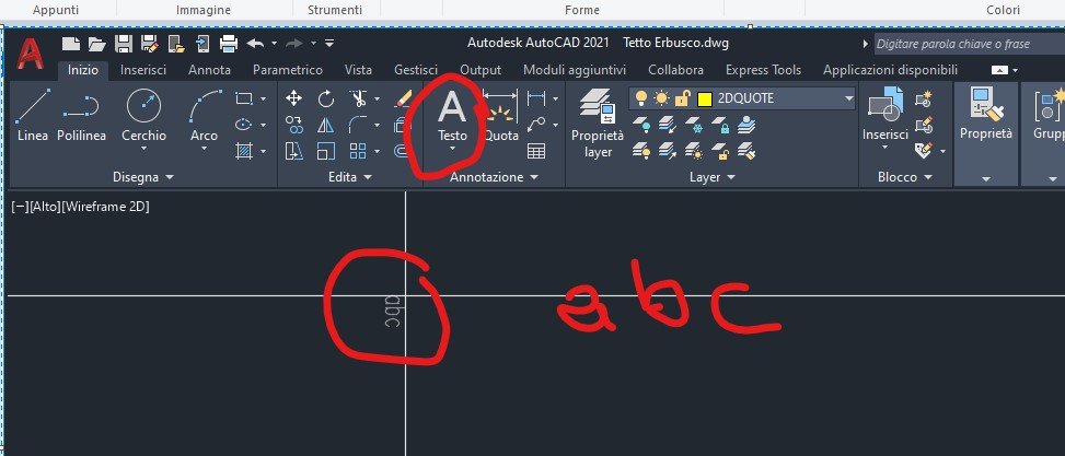

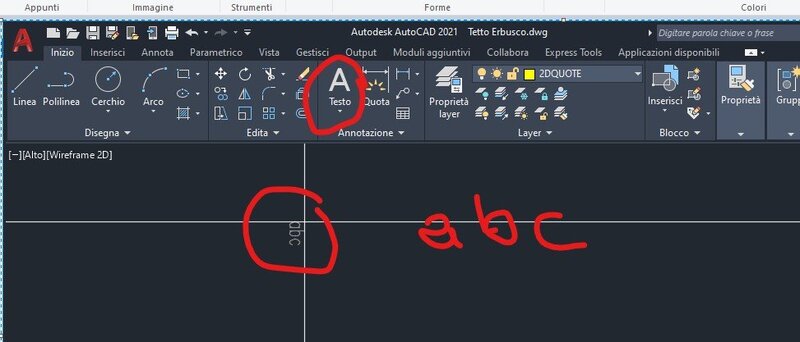

Giovannino60 Posted September 25, 2022 Author Posted September 25, 2022 (edited) On autocad in Italian I do not find these variables. I probably need to find the correct translation, but I can't find it ... I insert some pictures of the problem ... Edited September 25, 2022 by Giovannino60 Quote
tombu Posted September 25, 2022 Posted September 25, 2022 Other that the variables BIGAL mentioned default Text angle is the last text angle used in the drawing which isn't stored anywhere. You could also be in a rotated view or UCS. Quote
BIGAL Posted September 25, 2022 Posted September 25, 2022 Try this copy to command line. It should be language independent. (setvar 'angdir 0) (setvar 'angbase 0) Quote
