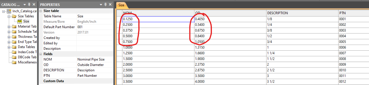

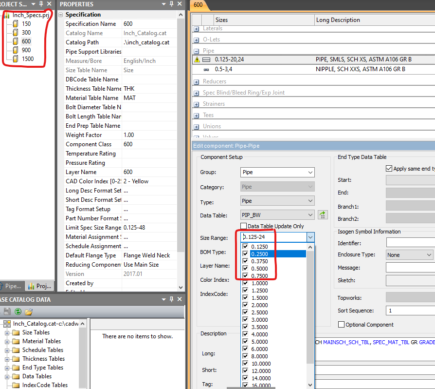

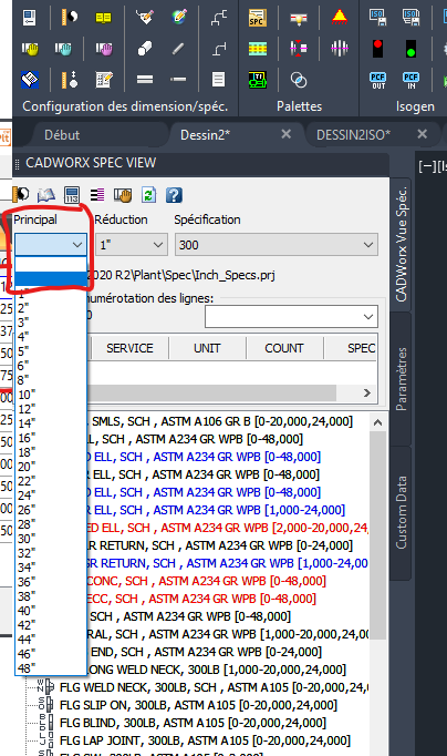

Problem: impossible to create lines with a diameter less than 1''.

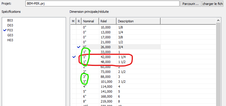

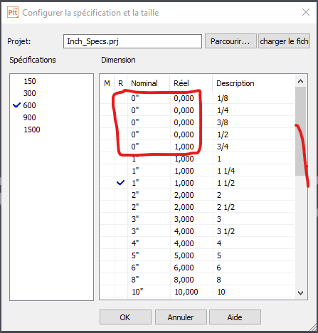

By choosing the spec of, I notice the absence of diameters less than 1', then which appear well in the spec-editor. (see attached images).
Irregular diameters such as 2'1/2 or 3'1/2 are also missing or incorrectly entered. Unable to use.
