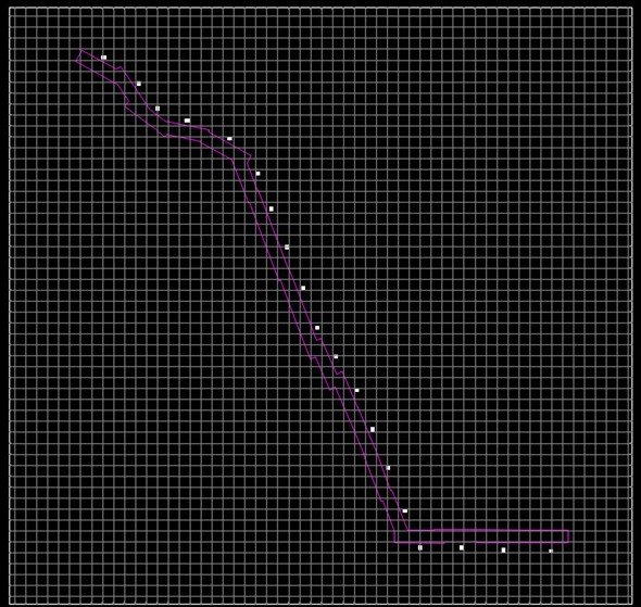

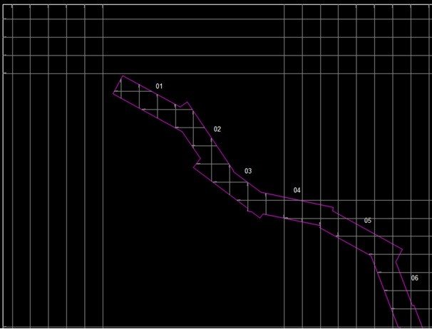

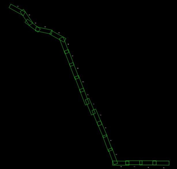

Dear All,
Is there any way of drawing grid lines with values for an area inside a polygon of irregular shape for the profile sheets.
Here I make a overall grid, then move the eating and northing values inside the polygon and then trim the lines outside the polygon.
Is there any shorter process for getting the same results.
Attached are the images for reference.
12 hours ago, mhupp said:
Maybe a hatch then change the scale to meet your spacing.
Thanks, Then how about the easting and northing coordinates text.
Did you look at what I posted ?
There is a lot of work that goes into writing the text at the end of grid lines correctly. Finding them all etc.
Edited by BIGAL

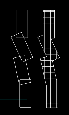

To simplify the grid creation you can:
  1. Create regions from the rectangles.
  2. Use UNION to create a single region boundary.
  3. Hatch using, for example, ANSI37 at 45°
  4. Change scale as needed.
  5. Specify origin as needed.
To use an existing AutoCAD hatch pattern like ANSI137 to give a 100 by 100 unit grid would involve scale factors of 800 or 31.496 depending on imperial or metric versions.
Much better to use a grid pattern where the basic spacing of 100 units is easier to deal with.
*GRID100, Grid 100 x 100 units
0, 0, 0, 0, 100
90, 0, 0, 0, 100
On 9/3/2022 at 4:40 PM, CADWORKER said:
Dear All,

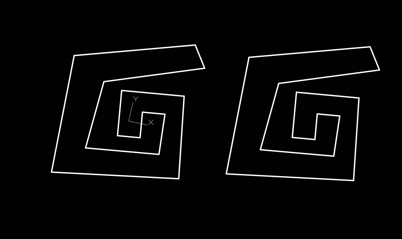

Hi
Here is a lisp from my archive
Works in WCS and parallel UCS. Z rotation allowed, but not 3D rotation.
Text is inserted in both ends of each line
Text height is 1% of grid spacing.
;Stefan M. 12.02.2018

Dear Mr. Stefan BMR,
THANKS FOR THIS WONDER FUL CODE,
Just a kind request if you could add a space at the start and end of the text values to as it will have a clearance from the limits (boundary line).
I look into your code and can add a space before the text values by replacing "N " to " N ". But could not figure it to add at the end.
Once again thanks a lot.
Code updated in my previous post.
