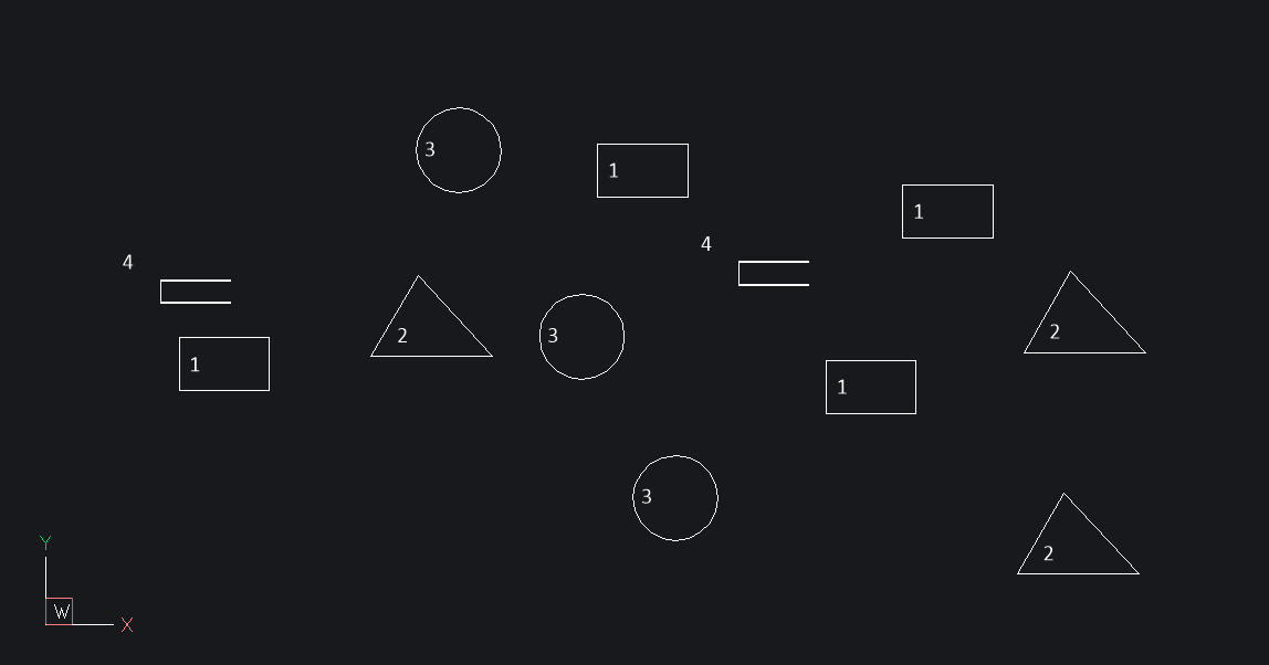

Hi @Tharwat.
after a long time, I have a question about the lisp:
is it possible to give every block type in the drawing the same number?
let say that I have 4 types of blocks and each of them appears several times.
I need that each block type will get the same number.
I attached a sample drawing with the needed resault along with the screen shot here.
thanks,
aridzv.

Did you post this question some where else I seem to remember it. A simple answer is yes get all blocks as a list, of name and entity name, sort on name, then go through the list comparing pairs if same then add to a  new list is (Bname entity 1) once the bname changes the list becomes (bname entity 2) and so on.
The location of the text is a bit tricky I would start with a bounding box and find mid pt. Using an attribute would be better.

Try this

Hi @BIGAL and thanks for the reply.
I see that the numbers are entered as text.
is it possible to enter them in to the ORDER tag attribute of the blocks?
aridzv.
Edited by aridzv

BigAls code is working well, just needs to add the value to the tag 'Order' in the last loop instead of writing it as text.
He'll be along later no doubt with some inspired piece of code, probably a line to add that will do that.
For now have a look at this and see if you can fit it in, untested but might just work
;;Add this line at the end of BighAls 'foreach' section, above the line (commansd "Text"....)
(LM:vl-setattributevalue blk "Order" (nth 2 blk) )

Hi @Steven P and thanks for the reply.
I'm getting this error:
; ----- Error around expression -----
; (BLK "ORDER" (VLE-NTH2 BLK))
; in file :
; C:\Temp\wow.lsp
thanks,
aridzv
