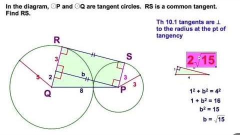

How to Draw Common External Tangent of 2 Circles?
Can someone tell me please how to draw common external tangent of 2 circles such as below pic? Please teach me the technical drawing method of it. Thanks

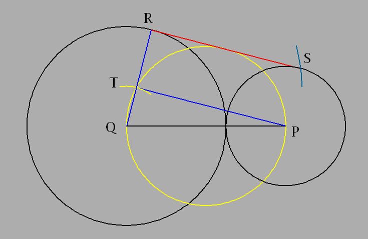

1. Draw a circle with QP as diameter.
2. Set radius to 2 and draw arc to intersect this circle at T
3. Draw QT and extend to R
4. Draw PT
5. Set radius to PR and centered on T draw an arc at S
6. Draw RS
Do you want the theory as well?
Edited by eldon
added to

@eldon
In an earlier post you stated:
4. Draw PT
6. Draw RS
I think step 5 should be
5. Set radius to TP and draw arc cenetered at R to determine S.
34 minutes ago, lrm said:
@eldon
4. Draw PT
6. Draw RS
It is heartening to see others who can see the basic geometry - thank you.
I was trying to match diagonals of the right angled rectangle, but your solution matches the side length. Both solutions should give the same answer (I hope!)
Yes, you are correct, both methods will work!  I was fixated on the fact that since RT and SP  are parallel, RS = TP but of course, the diagonals of a rectangle will be equal as well.
