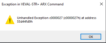

TemporaryCAD Posted September 6, 2022 Share Posted September 6, 2022 I am building a DCL interface for inserting multiple blocks at once. I have a core DCL window where you select what you want to insert. These buttons popup a new window where specific information is entered to select each insertion. At the end, code should be ran that handles the entered information and the user selects the insertion point. I believe it's the (getpoint) function that is causing trouble. I found an example of how to do this via hiding the dialog, but I want to close it. Essentially, I want the DCL component of the code to completely finish before running the insertion function. Please let me know if you know of a solution or a resource you could point me to. Thank you! Quote Link to comment Share on other sites More sharing options...

TemporaryCAD Posted September 6, 2022 Author Share Posted September 6, 2022 11 minutes ago, Steven P said: When you click the OK button on a DCL the box closes but the LISP calling it continues to run, so you can save all the user inputted data as variables, finish and close the DCL as required then continue from there with a getpoint Does this only work for OK buttons? When I try to close dcl in a command, I'll put both unload_dialog and MyFunction in the action tile field. This leads to me getting an error (see attached). I'm clearly doing something wrong! - thanks for the help. Quote Link to comment Share on other sites More sharing options...
TemporaryCAD Posted September 6, 2022 Author Share Posted September 6, 2022 I'm going to share some more details in hopes of finding a solution. Here's the basic line: (action_tile "build" "(term_dialog) (execute)") Where execute is the function I am trying to run. This leads to the error pictured above. However, when I run: (action_tile "build" "(term_dialog)") Everything works fine. I think the problem is related to getpoint, and I'm not really sure why. Any help is greatly appreciated! Quote Link to comment Share on other sites More sharing options...

TemporaryCAD Posted September 7, 2022 Author Share Posted September 7, 2022 4 hours ago, Steven P said: First a comment that in my LISPs containing a DCL I have them (action_tile "Build" "(execute) (term_dialogue)") not sure if the order makes a difference. Here is one thing that I have used (action_tile "build" "(setq MyAction \"Evaluate\")(done_dialog)") ... ... (eval (list (read "MyAction"))) This was from a DCL box where the user can choose what to run, their selected LISP is saved as a variable and then run later This worked! Thank you so much! I was working through this thread in order of easiest to hardest. I tried swapping the order of commands (didn't work) and the alluded to (vla-sendcommand) function (still led to the same problem). However (eval (list ( /string of command name incl parentheses /))) works perfectly. This is my initial time using eval in this way, and it's quite awesome - it's the first time I've felt lisp can do something better than another language. This has been a great learning experience. 1 Quote Link to comment Share on other sites More sharing options...
