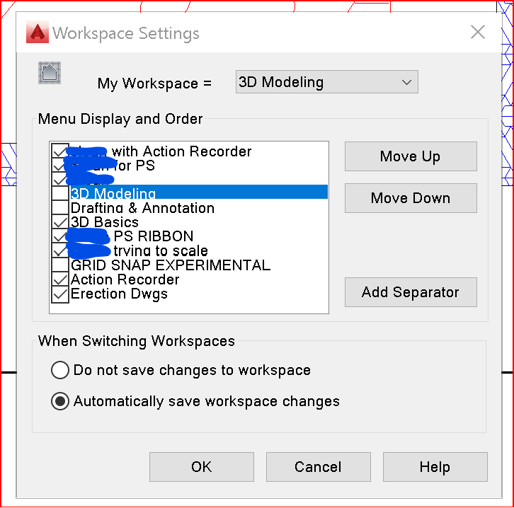

Might you want to check and possibly change your Workspace Settings?
As shown in the screenshot
I don't have Auto save turned on if you do something wrong in say a custom menu and it screws up the menus, closing Cad means you return to the screwed up workspace and its a pain to have to go into CUI and look for all the CUIX files that no longer exist, I have had "File" and that was it all menu's gone !
