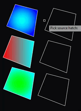

leonucadomi Posted September 2, 2022 Share Posted September 2, 2022 Good afternoon, is there any way to select a hatch and then click an area and generate that same hatch? with the same properties. Quote Link to comment Share on other sites More sharing options...

ronjonp Posted September 8, 2022 Share Posted September 8, 2022 (edited) On 9/5/2022 at 6:23 AM, leonucadomi said: I do it by copying properties with MA - Matchprop., but but i want to make fewer moves , and what occurs to me is to touch a hatch , capture their properties and copy them by selecting a point within an area. it would be a total of two steps. 1.- (entsel) the origin hatch 2.- (getpoint) the interior point of the area. they are just my ideas. @leonucadomi Give this a try: (defun c:foo (/ a b e h hp p x) ;; RJP » 2022-09-08 (cond ((and (setq e (car (entsel "\nPick source hatch: "))) (= "HATCH" (cdr (assoc 0 (entget e)))) (setq b (assoc 2 (entget e))) (setq e (vlax-ename->vla-object e)) (setq a (mapcar '(lambda (x) (list x (vlax-get e x))) '(associativehatch backgroundcolor elevation entitytransparency gradientangle gradientcentered gradientcolor1 gradientcolor2 gradientname hatchobjecttype hatchstyle isopenwidth layer linetype linetypescale lineweight material origin patternangle patterndouble patternscale patternspace plotstylename truecolor visible ) ) ) ) (setq hp (getvar 'hpname)) (setvar 'hpname (cdr b)) (while (setq p (getpoint)) (setq h (entlast)) (command "_.bhatch" p "") (cond ((not (equal h (setq h (entlast)))) (setq h (vlax-ename->vla-object h)) (foreach x a (vl-catch-all-apply 'vlax-put (list h (car x) (cadr x)))) ;; patternname (RO) cannot be set via vla for some reason ? ;; (setq h (entget (vlax-vla-object->ename h))) ;; (entmod (subst b (assoc 2 h) h)) ) ) ) (setvar 'hpname hp) ) ) (princ) ) Edited September 8, 2022 by ronjonp 5 1 Quote Link to comment Share on other sites More sharing options...

ronjonp Posted September 9, 2022 Share Posted September 9, 2022 (edited) My code above matches colors as well as gradients Edited September 9, 2022 by ronjonp 3 Quote Link to comment Share on other sites More sharing options...
aridzv Posted September 9, 2022 Share Posted September 9, 2022 (edited) Hi @ronjonp I've tried to use your code but it failed. when i run the code it lets me pick the source hatch and then the lisp ends without continue to the HATCH command and without any error massages - it just ends... I'm using Bricscad so mybe that is the reason and some adjusment need to be done? regards, aridzv. Edited September 9, 2022 by aridzv Quote Link to comment Share on other sites More sharing options...

aridzv Posted September 9, 2022 Share Posted September 9, 2022 (edited) @ronjonp O.K.!! I've remooved gradientcolor1 & gradientcolor2 from the properties list and it's working!! In addition to the new lisp, I also learned about the BLADE debugging tool, so thanks x 2.. regards, aridzv Edited September 10, 2022 by aridzv Quote Link to comment Share on other sites More sharing options...

3dwannab Posted March 3, 2023 Share Posted March 3, 2023 On 9/9/2022 at 2:40 PM, ronjonp said: My code above matches colors as well as gradients Nice program. I was hoping to retain the boundaries. I've modified the script to include "Undo handling, hiding objects and retain boundaries). Is it doable to retain the boundaries but set the layer to something? Here's my version: (defun c:foo (/ *error* a b e h hp p x ssHide var_cmdecho var_hpannotative var_hpassoc var_hpbound var_hpboundretain var_hpseparate var_osmode var_selectioncycling var_snapmode) ; 2023.03.03, 3dwannab edit, added undo handling and hiding objects, also retain boundaries. (defun *error* (errmsg) (and acDoc (vla-EndUndoMark acDoc)) (and errmsg (not (wcmatch (strcase errmsg) "*CANCEL*,*EXIT*")) (princ (strcat "\n<< Error: " errmsg " >>\n")) ) ;;; Unhides the selection set (if ssHide (acet-ss-visible ssHide 0)) (setvar 'cmdecho var_cmdecho) (setvar 'hpannotative var_hpannotative) (setvar 'hpassoc var_hpassoc) ; (setvar 'hpbackgroundcolor var_hpbackgroundcolor) ;; No need to use this. The add selected command will get this. (setvar 'hpbound var_hpbound) (setvar 'hpboundretain var_hpboundretain) (setvar 'hpseparate var_hpseparate) (setvar 'osmode var_osmode) (setvar 'selectioncycling var_selectioncycling) (setvar 'snapmode var_snapmode) ) (setq acDoc (vla-get-ActiveDocument (vlax-get-acad-object))) (or (vla-EndUndoMark acDoc) (vla-StartUndoMark acDoc)) (setq var_cmdecho (getvar "cmdecho")) (setq var_hpannotative (getvar "hpannotative")) (setq var_hpassoc (getvar "hpassoc")) ; (setq var_hpbackgroundcolor (getvar "hpbackgroundcolor")) ;; No need to use this. The add selected command will get this. (setq var_hpbound (getvar "hpbound")) (setq var_hpboundretain (getvar "hpboundretain")) (setq var_hpseparate (getvar "hpseparate")) (setq var_osmode (getvar "osmode")) (setq var_selectioncycling (getvar "selectioncycling")) (setq var_snapmode (getvar "snapmode")) (setvar 'osmode 0) (setvar 'cmdecho 0) (setvar 'hpassoc 1) ; (setvar 'hpbackgroundcolor ".") ;; No need to use this. The add selected command will get this. (setvar 'hpbound 1) ; Create polyline boundary (setvar 'hpboundretain 1) ; Retain boundaries (setvar 'hpseparate 1) ; Separates the hatches to each boundary. (setvar 'selectioncycling 2) ;; 0 = The display options are turned off, 1 = A badge displays when you hover over objects that overlap, 2 = Both a badge and the Selection dialog box displays. (setvar 'snapmode 0) ; gridsnap: 0 off, 1 = 0n ;; Put any text, leaders, multileaders or dimensions into a selection set and ;; hides them. The error handler will undo this. (setq ssHide (ssget "_X" '((0 . "*TEXT,LEADER,MULTILEADER,DIMENSION")))) (acet-ss-visible ssHide 1) ; Hides ssHide ;; RJP » 2022-09-08 (cond ((and (setq e (car (entsel "\nPick source hatch: "))) (= "HATCH" (cdr (assoc 0 (entget e)))) (setq b (assoc 2 (entget e))) (setq e (vlax-ename->vla-object e)) (setq a (mapcar '(lambda (x) (list x (vlax-get e x))) '(associativehatch backgroundcolor elevation entitytransparency gradientangle gradientcentered gradientcolor1 gradientcolor2 gradientname hatchobjecttype hatchstyle isopenwidth layer linetype linetypescale lineweight material origin patternangle patterndouble patternscale patternspace plotstylename truecolor visible) ) ) ) (setq hp (getvar 'hpname)) (setvar 'hpname (cdr b)) (setvar 'hpboundretain 1) ; Retain boundaries (while (setq p (getpoint)) (setq h (entlast)) (command "_.bhatch" p "") (cond ((not (equal h (setq h (entlast)))) (setq h (vlax-ename->vla-object h)) (foreach x a (vl-catch-all-apply 'vlax-put (list h (car x) (cadr x)))) ;; patternname (RO) cannot be set via vla for some reason ? ;; (setq h (entget (vlax-vla-object->ename h))) ;; (entmod (subst b (assoc 2 h) h)) ) ) ) (setvar 'hpname hp) ) ) (*error* nil) (princ) ) Quote Link to comment Share on other sites More sharing options...
