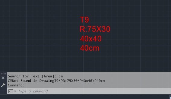

egilim123 Posted September 19, 2022 Author Share Posted September 19, 2022 hello again , in the attached file , there are copper pipes (orange color) , and pvc pipes (red color) , for pvc pipes (red colored) when i use the lisp ST i search for 40 for example it finds and writes all Q40 pipes on the below list (command window) but for the copper pipes (orange colored) they are written as inch dimensions for example i search for 5/8" it cannot find how can i use it for also inch dimensions? Drawing4.dwg Quote Link to comment Share on other sites More sharing options...
egilim123 Posted September 19, 2022 Author Share Posted September 19, 2022 if i search in Autocad's find command when i search mt (means meter) i can see all the copper pipes list in below list as in the attached file but i cannot copy that list and take it into excel if there is a way to copy Autocad's FİND list it also helps me, thanks Quote Link to comment Share on other sites More sharing options...

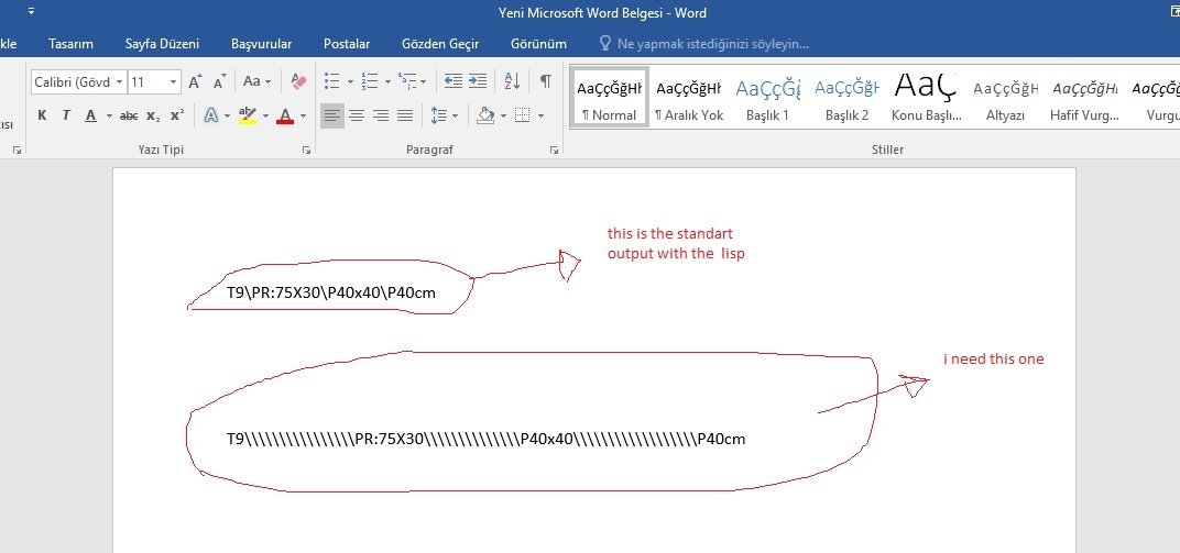

egilim123 Posted November 11, 2022 Author Share Posted November 11, 2022 Hi again @Steven P, the lisp works perfectly for me but i need a little bit an add-on. Can we also put something like "\" , i need this to seperate the rows(long seperation) that i copy from Autocad with your lisp. i probably couldnt make myslef clear but i will try it with the attached files. Quote Link to comment Share on other sites More sharing options...
BIGAL Posted November 13, 2022 Share Posted November 13, 2022 So want blank lines just add \P. Quote Link to comment Share on other sites More sharing options...
egilim123 Posted November 14, 2022 Author Share Posted November 14, 2022 hi @BIGAL, where can i add the lisp in this lisp? st.rar Quote Link to comment Share on other sites More sharing options...
Steven P Posted November 14, 2022 Share Posted November 14, 2022 On 11/11/2022 at 7:29 AM, egilim123 said: Hi again @Steven P, the lisp works perfectly for me but i need a little bit an add-on. Can we also put something like "\" , i need this to seperate the rows(long seperation) that i copy from Autocad with your lisp. i probably couldnt make myslef clear but i will try it with the attached files. if I remember what I did above correctly (a couple of weekends and a holiday ago), I have this line: (setq Selectedtexts (strcat Selectedtexts (chr 10) texta)) where (chr 10) is the carriage return or new line character. You can replace that with the '\\\\.... \\p" and it should work. Note however that \ is the marker for a special character in a LISP string, to get a \ as a part of the string you might need to put a double \\ in for each single one you want to use. Quote Link to comment Share on other sites More sharing options...
egilim123 Posted November 15, 2022 Author Share Posted November 15, 2022 in this line (setq Selectedtexts (strcat Selectedtexts (chr 10) texta)) i tried these; (setq Selectedtexts (strcat Selectedtexts '\\\\.... \\p" texta)) (setq Selectedtexts (strcat Selectedtexts \\\\\\\\p texta)) (setq Selectedtexts (strcat Selectedtexts (\\\\\\\\p) texta)) (setq Selectedtexts (strcat Selectedtexts \\\\\\\\ texta)) (setq Selectedtexts (strcat Selectedtexts (chr10\\\\\\\\) texta)) .................... and some more but none of them worked it gives; 9 Entitys containing "CM"; error: bad argument type: fixnump: nil 9 Entitys containing "CM"; error: bad argument type: stringp nil 9 Entitys containing "CM"; error: no function definition: \\\\\\\\\\\\\\\\P and such kind of errors. Quote Link to comment Share on other sites More sharing options...
Steven P Posted November 15, 2022 Share Posted November 15, 2022 try this one: (setq Selectedtexts (strcat Selectedtexts "\\\\\\p" texta)) (your first one had a typo, a single quote mark, not double at the start of the \\\\ - the others needed that in there since you are typing in a string and not a variable ) Quote Link to comment Share on other sites More sharing options...

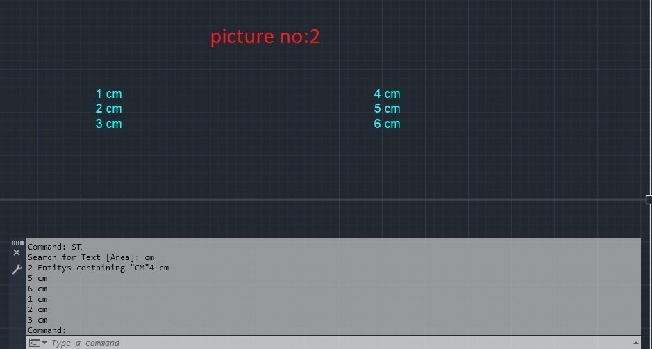

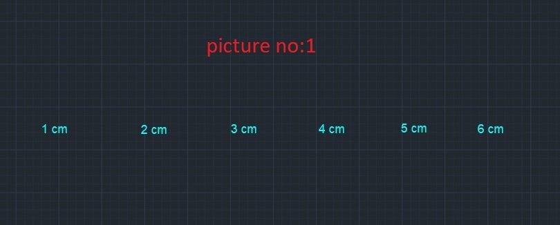

egilim123 Posted November 15, 2022 Author Share Posted November 15, 2022 (edited) and one more questiion ; when i want to arrange the attached sample3 dwg , (picture no:1) i for exampla make 1-2-3 a group and 4-5-6 another group (picture no:2) then when i want to take them to word i use your ST lisp and it takes the output as picture no:3 but can we make the output datas as in picture no:4 , the first group (1-2-3) in the same line and he second group (4-5-6) in their lines and \\\\\ between each other sample3.dwg Edited November 15, 2022 by egilim123 Quote Link to comment Share on other sites More sharing options...
