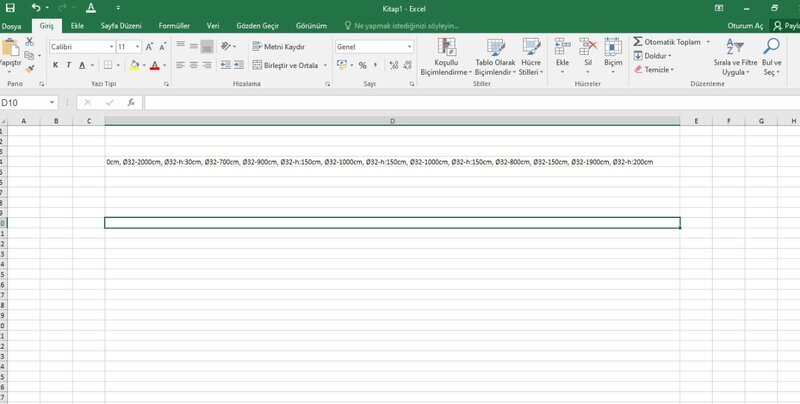

egilim123 Posted September 2, 2022 Author Share Posted September 2, 2022 thanks all for your interest , i tried mhupp s code but it only hıghlıghts the text i search and i tried Stevens additonal codes on mhupps code and its still the same it choses and highlights all the text i search but after i ctrl+c all the chosen things and i ctrl+v it on the excel they dont come as a text but they come as jpeg and i cannot use them in a excell cell Quote Link to comment Share on other sites More sharing options...

egilim123 Posted September 2, 2022 Author Share Posted September 2, 2022 @Steven Pi tried your code with adding it to mhupps , i typed st as the command, when i run the lisp it asks ,search for the text i write for example 32 and it selects all the 32's and they also shown in the command line and i can copy them from the command lines and i copied them to excel cells Quote Link to comment Share on other sites More sharing options...
egilim123 Posted September 2, 2022 Author Share Posted September 2, 2022 thank you very much so now the only thing left is to seperate them to different excel cells because this way i can only take them to 1 excel cell but i need to take all different lengths to different cells so that i can sum up them easily. thanks very much @Steven P and to everyone involved Quote Link to comment Share on other sites More sharing options...
egilim123 Posted September 2, 2022 Author Share Posted September 2, 2022 here are the screenshots Quote Link to comment Share on other sites More sharing options...
Steven P Posted September 2, 2022 Share Posted September 2, 2022 I think if I put in a copy to clipboard at the end of what I did, I can make it go to different cells, will try it shortly and let you know Quote Link to comment Share on other sites More sharing options...
Steven P Posted September 2, 2022 Share Posted September 2, 2022 Got to love end of week team meetings, try this: This should copy the selected texts to the clipboard, paste into excel the usual way, paste, ctr+V, whatever, each selected text is on a new line in excel. (defun SetClipBoardText ( MyText / htmlfile result ) (vlax-invoke (vlax-get (vlax-get (setq htmlfile (vlax-create-object "htmlfile")) 'ParentWindow) 'ClipBoardData) 'setData "Text" Mytext) (vlax-release-object htmlfile) (princ) ) (defun C:ST (/ txt ss typ) (if (eq (setq txt (strcase (getstring "\nSearch for Text [Area]: "))) "");hit enter for defult options. (setq txt "AREA") ;set defult search options here ) (if (setq ss (ssget "_X" (list '(0 . "MTEXT,TEXT,MULTILEADER,DIMENSION") (cons 410 (getvar 'ctab))))) (foreach ent (vl-remove-if 'listp (mapcar 'cadr (ssnamex ss))) (setq typ (cdr (assoc 0 (entget ent)))) (cond ((member typ '("TEXT" "MTEXT" "MULTILEADER")) (setq obj (vlax-ename->vla-object ent)) ;convert to val-object (if (vl-string-search txt (strcase (vlax-get obj 'TextString))) (progn) ;if found leave in selection set (ssdel ent ss) ;if not found in string remove from selection s ) ) ((eq typ "DIMENSION") (setq obj (vlax-ename->vla-object ent)) ;convert to val-object (if (vl-string-search txt (strcase (vlax-get obj 'TextOverride))) (progn) ;if found leave in selection set (ssdel ent ss) ;if not found in string remove from selection s ) ) ) ) ) (if (> (sslength ss) 1) ;if anything is still in the selection set (progn (prompt (strcat "\n" (itoa (sslength ss)) " Entitys containing \"" txt "\"")) (sssetfirst nil ss) ) (prompt (strcat "\n" txt "Not Found in Drawing")) ) (setq Selectedtexts nil) (setq acount 0) (while ( < acount (sslength ss)) (if (= nil Selectedtexts) (setq Selectedtexts (cdr (assoc 1 (entget (ssname ss acount))))) (setq Selectedtexts (strcat Selectedtexts (chr 10) (cdr (assoc 1 (entget (ssname ss acount)))))) ) (setq acount (+ acount 1)) ) ; end while (SetClipBoardText Selectedtexts) (princ Selectedtexts) (princ) ) 1 Quote Link to comment Share on other sites More sharing options...

egilim123 Posted September 3, 2022 Author Share Posted September 3, 2022 hi again everyone, i tried @Steven Pnew code and yes it worked for me, its indeed very good , it will do my job , thanks very much again @Steven P, i wish nice weekends for all and hope to write you again. 1 Quote Link to comment Share on other sites More sharing options...
