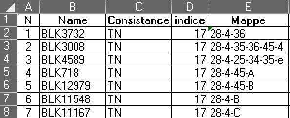

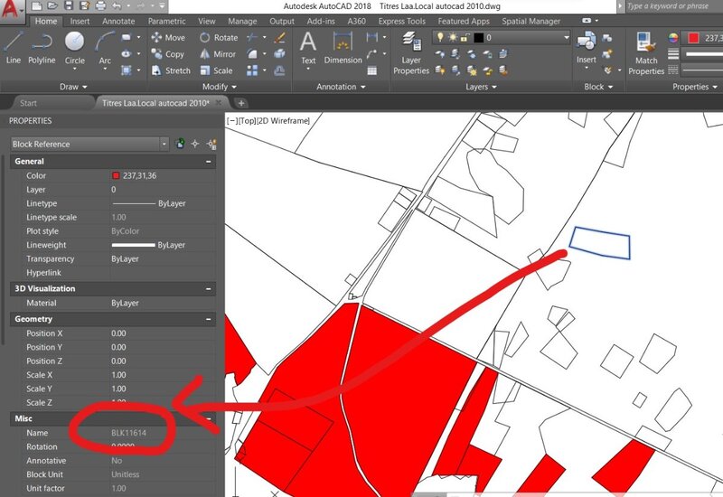

I am working on an AutoCAD drawing that contains more than 10,000 blocks with different names, and I want to SELECT about 1000 blocks so that I can transfer them to another AutoCAD file for modification.
Is there any way that I can select multiple blocks by name only (I have a list in Excel), knowing that I tried a set of commands like FILTER, QSELECT and also I tried to export blocks attribut but it didn't work for me.
