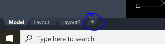

When you pick the (+) to add a new layout,
can that new layout have a title block (or other) appear as a default?
We have a dynamic block/title block with multiple sheets in the drop down with numbered zones
and we would like that to appear when the (+) is picked. - if possible.

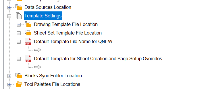

I tried filling in these settings with templates but what they did was start NEW drawings with a template.
(Which was nice) but not what I am after.
We are not using Sheet Sets where I work (if that matters)

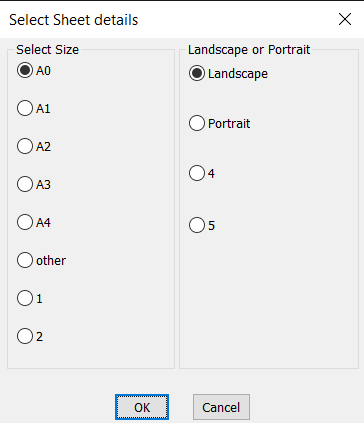

You can program a choice of say what layout to use from another dwg. When you type layout use the "T" option and it will ask for a dwg, then ask for a layout name. I have for a clilent around 30 client names so pick from list, then size and orientation, a new correct layout is created.
(command "layout" "T"  "Master layouts-2022.dwg" ntitle )
Can provide more detail.
