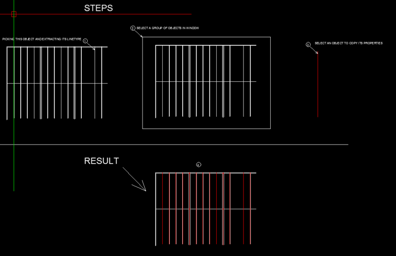

leonucadomi Posted August 23, 2022 Share Posted August 23, 2022 Hi everyone: I am trying to do the following in 3 steps. 1.- a line will be touched, it will store its line type in a variable. can be hidden, continuos, phantom .. no matter what 2.- then a selection will be made in a window of a group of lines and it will be filtered. Only lines with the linetype of the first object will be selected 3.- A line will be selected and all its properties will be copied to the group selected in the window. (Step 2) I do not want to use the quick selection of autocad. I hope someone can help me. EXAMPLE.dwg Quote Link to comment Share on other sites More sharing options...
mhupp Posted August 23, 2022 Share Posted August 23, 2022 (edited) https://forums.autodesk.com/t5/visual-lisp-autolisp-and-general/select-similar-by-window-selection/m-p/4348047/highlight/true#M313697 This is basically what I use. --edit Added code for #3 (defun c:SSW (/ filter ss1 ss2 ss3 add i e) ;; Select Similar within Window ;; Uses core SelectSimilar command ;; Alan J. Thompson, 2013.07.30 (setq filter (if (eq (getvar 'CVPORT) 1) (list (cons 410 (getvar 'CTAB))) '((410 . "Model")) ) ) (princ "\nSelect objects to select similar: ") (if (and (setq ss1 (ssget filter)) (progn (princ "\nSelect area to select similar object(s) within: ") (setq ss2 (ssget filter)) ) ) (progn (command "_.selectsimilar" ss1 "") (if (setq ss3 (ssget "_I" filter)) (progn (sssetfirst nil nil) (setq add (ssadd)) (repeat (setq i (sslength ss3)) (if (ssmemb (setq e (ssname ss3 (setq i (1- i)))) ss2) (setq add (ssadd e add)) ) ) ;(sssetfirst nil add) ;not need for matchprop ) ) ) ) (command "_.Matchprop" pause add "") ;only line added (princ) ) Edited August 23, 2022 by mhupp Quote Link to comment Share on other sites More sharing options...
