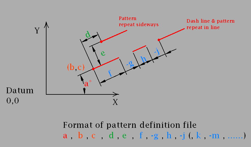

eldon Posted August 24, 2022 Share Posted August 24, 2022 I am glad it helped you. Here is a diagram of how the data for the pattern definition file is derived. 1 Quote Link to comment Share on other sites More sharing options...

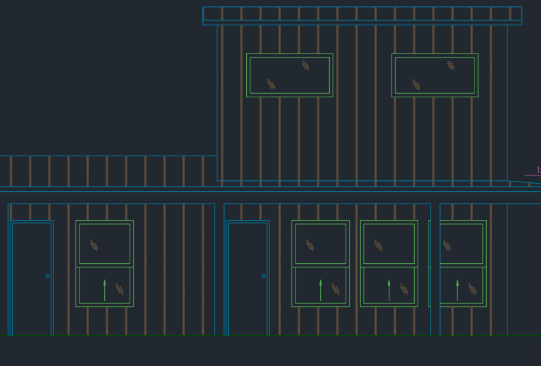

Mory Posted August 24, 2022 Author Share Posted August 24, 2022 Thanks eldon.. cant tell you how happy i am to be having this going now... my boss was kinda wanting me to do a custom hatch to make the dwg look better so i am sure he will like this! Thanks for the definition... i screenshoted it to refer to... did i just past tense a noun?? also i attached this screenshot to display how the pattern looks... thx again! Quote Link to comment Share on other sites More sharing options...
CyberAngel Posted August 30, 2022 Share Posted August 30, 2022 Looks good! Quote Link to comment Share on other sites More sharing options...

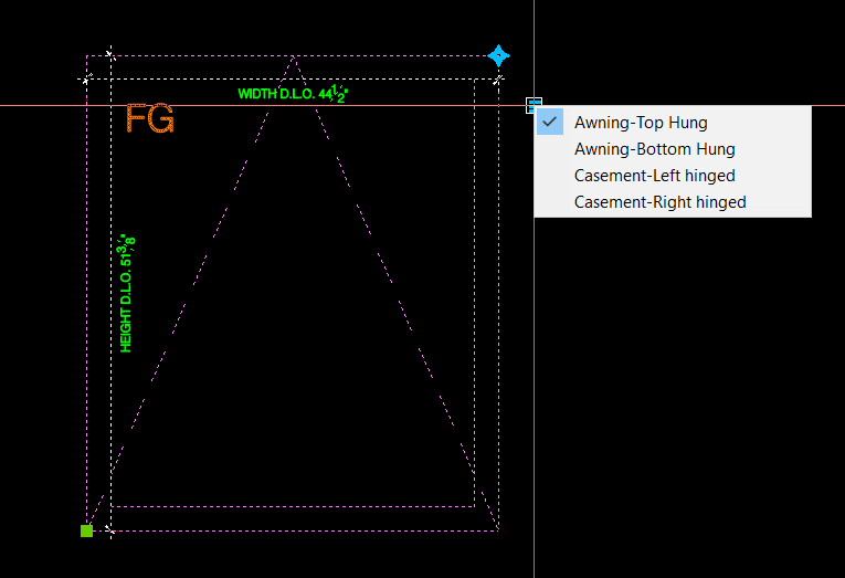

BIGAL Posted August 30, 2022 Share Posted August 30, 2022 Agree Mory have you looked at dynamic blocks for your windows etc ? Not only width & height, but style. Sorry not my blocks. Quote Link to comment Share on other sites More sharing options...
Mory Posted September 1, 2022 Author Share Posted September 1, 2022 Hi Bigal yes we used those where i used to work but my boss here likes to customize everything to look the way he likes so i am just slowly building a block library to suit the tastes of my management team here... have to be flexible in this business right? plus i have a technique of inserting blocks that imho is quite hard to beat... just have to take the time first to develop a block naming system that is short and sort of makes sense to remember... Quote Link to comment Share on other sites More sharing options...
Mory Posted September 1, 2022 Author Share Posted September 1, 2022 On 8/30/2022 at 7:29 AM, CyberAngel said: Looks good! Thanks Cyberangel! I came from the oil and gas industry so one of the things i am liking about the architectural field is that the drawings are more interesting to look at right? not just a bunch of pipes flanges and brackets... but this corporate getaway building looks much more accurate/realistic with this custom hatch than the ones out of the box acad... this forum is such an amazing resource! Quote Link to comment Share on other sites More sharing options...
BIGAL Posted September 2, 2022 Share Posted September 2, 2022 Yeah making blocks to suit is a big problem, you can use scale sometimes to stretch a block in X & Y is a quick way for simple different styles, I mean do you really need to check that the frame is 50mm or is 2 lines ok. You could make a window program, ie draw lines etc, then turn it into a block or maybe a simple GROUP would do same, so custom sizes can be generated. Your windows are 2 rectangs at simplest with a bit of hatch. Last comment the window image I showed is Length & Width driven and has multiple visibility states for different style widows, eg Left or Right. Quote Link to comment Share on other sites More sharing options...
