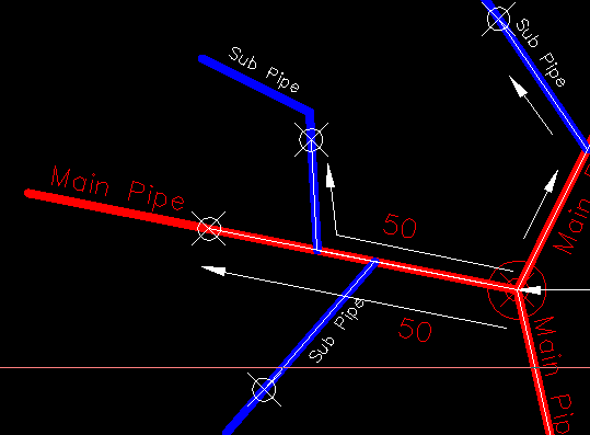

reza Posted August 27, 2022 Author Posted August 27, 2022 Your sense of perfectionism is commendable. The problem started here: Suppose we want to determine the location of fire hydrants for a city pipe network. According to the standard, each fire hydrant covers 1500 meters from its surroundings. So, with a 1500-meter buffer, the range of the first valve is determined, and with a 3000-meter buffer, the installation location of the next valve is determined. Please see link below (Maybe it can show the issue better) : As it is clear in the video, we can use the distance (length) parameter instead of the time parameter. You solved my problem in AutoCAD perfectly. Quote

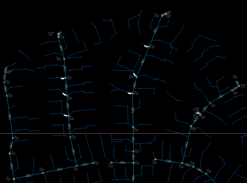

reza Posted September 3, 2022 Author Posted September 3, 2022 (edited) HI Dear Marko Unfortunately, the last code does not work correctly. Is it possible to set the entered parameters such as length and color as default? And don't exit the program until the user specifies a new point. And the sent code affects the other polylines in the dwg. THX IDEA Network Topology.dwgFetching info... Edited September 3, 2022 by reza Quote
marko_ribar Posted September 3, 2022 Posted September 3, 2022 Look, reza... It works... It's just that your CAD may be overloaded with other functions or routines that are autoloading at startup... It happens to me too, but for debugging purposes and working tasks, I have setup without other LSP that may consume memory... That could be the case and with you... I've tested routine very thoroughly and should perform well in any situation... Here is your DWG with 1250 DWG units like you tried... M.R. IDEA Network Topology-reza-check.dwgFetching info... Quote

Tsuky Posted September 6, 2022 Posted September 6, 2022 Hi all, is my first post here: I'am CADaSchtroumpf on forum AutoDesk. My try For a speed of execution it is asked to select only the polylines likely to be concerned by the iso-distance search Then the base/reference point of the measurement. This base point can be anywhere, if it is not at the origin or at the end of the polyline, it will be cut (but preserving the Map object data and/or the Xdata) You will also be asked for a fuzz for equality: network in large coordinates or standard. If a secondary polyline is not attached to a vertex of the primary polyline, a vertex will be inserted at this node. Tree research is done at all levels. In the end points are created at the iso-distance of the base point. iso_distance.fasFetching info... 1 Quote
