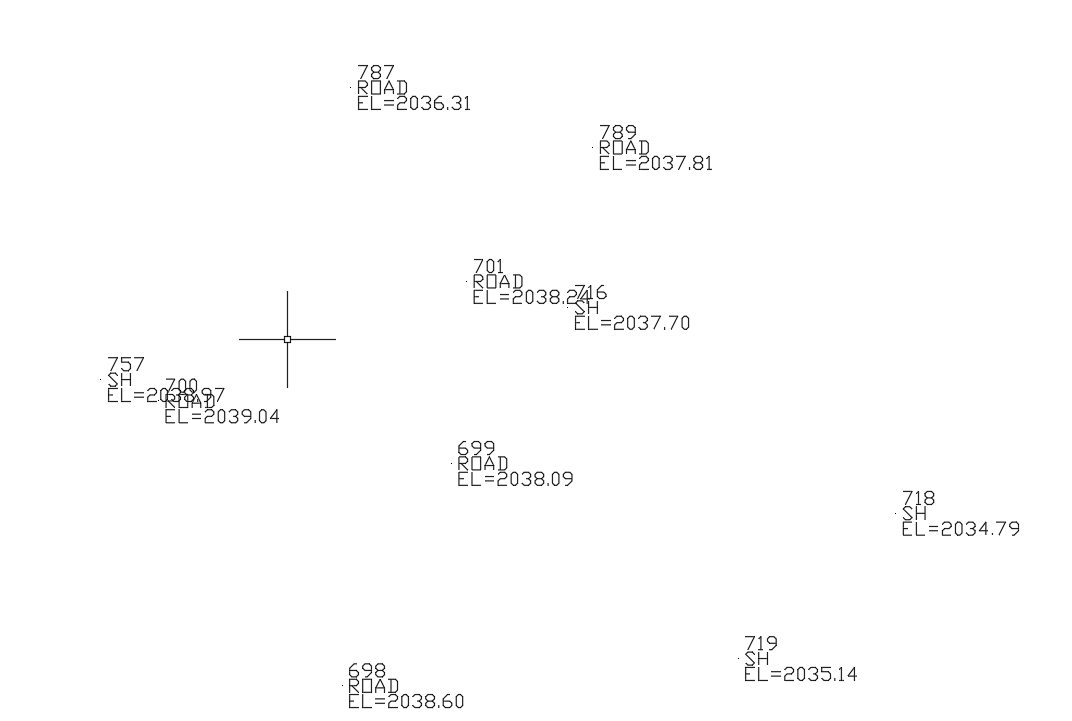

Saqib_theleo Posted August 19, 2022 Posted August 19, 2022 Hello All, I want to change block tag properties, I can change one by one as i showed in image but there are soo many i want change at once. how can I change linewieight of all at once. I also attached drawing file sample. Thank you. Block Attribute Line weight.dwg Quote
ronjonp Posted August 19, 2022 Posted August 19, 2022 It looks like that block was created programmatically? Quote Command: ATTSYNC This drawing contains no attributed blocks. 1 Quote
Saqib_theleo Posted August 20, 2022 Author Posted August 20, 2022 16 hours ago, ronjonp said: It looks like that block was created programmatically? Yes, it was created with some other program, not with Autocad. So here how can I change it. Quote

Steven P Posted August 21, 2022 Posted August 21, 2022 (edited) and finally, has anyone tried editing the block, adding 3 attributes, lets call them say PN, PD and ZC, then using attsync and see what happens? Edited August 21, 2022 by Steven P 1 Quote

Saqib_theleo Posted August 21, 2022 Author Posted August 21, 2022 5 hours ago, Steven P said: and finally, has anyone tried editing the block, adding 3 attributes, lets call them say PN, PD and ZC, then using attsync and see what happens? Nice one, I tried like you said and it works. Thanks for your suggestion and thinking. 2 Quote
ronjonp Posted August 22, 2022 Posted August 22, 2022 19 hours ago, Saqib_theleo said: Nice one, I tried like you said and it works. Thanks for your suggestion and thinking. Do this and also change your lineweight to 0.30 mm or put them on a layer that has the correct lineweight. Quote
Saqib_theleo Posted August 23, 2022 Author Posted August 23, 2022 (edited) 15 hours ago, ronjonp said: Do this and also change your lineweight to 0.30 mm or put them on a layer that has the correct lineweight. Yes it changes to Default lineweight and also if we want to change it to some other than default we can change it using "Battman" command. before it was not possible. Edited August 23, 2022 by Saqib_theleo Quote
