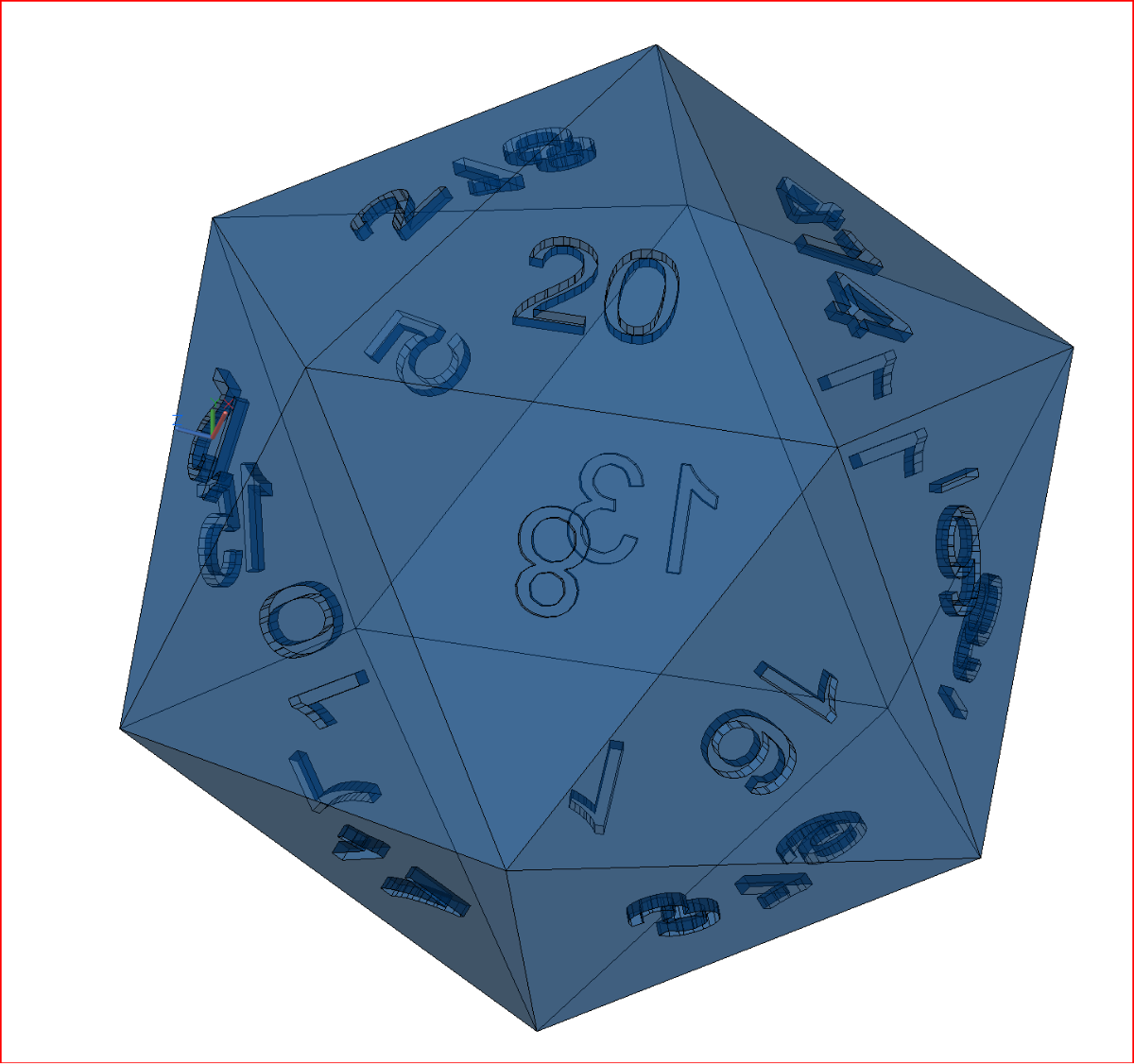

There you go.  Updated the dwg file, and changed my software version.  The updated file is the finished version that I got to work.  The numbers on the die faces are their own layer, and are recessed into the die itself when turned off.  Turned out well, just took a bit of work since CAD won't allow you to explode text unless you're in the top view (see YouTube video above), which kind of made the UCS/face command useless for this particular project.
An Icosahedron it is then.
Happy to see that the opposing face numbers total 21, as they should.   :beer:
Well done, it looks pretty interesting in X-Ray Visual style too.

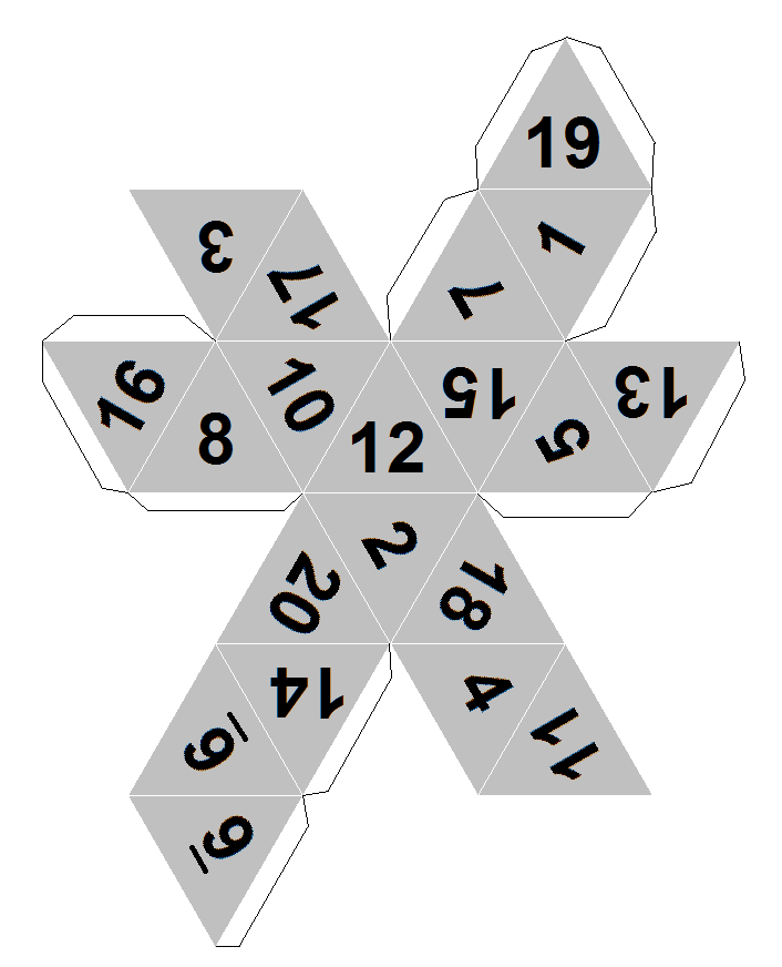

Yeah, I know nothing about table-top gaming.  I followed a 2D pattern that my friend sent me.  Basically, it laid out the pattern as if you were cutting it out on paper and could then fold it into the spherical shape.  That’s what I went by.

This is the template I used.
