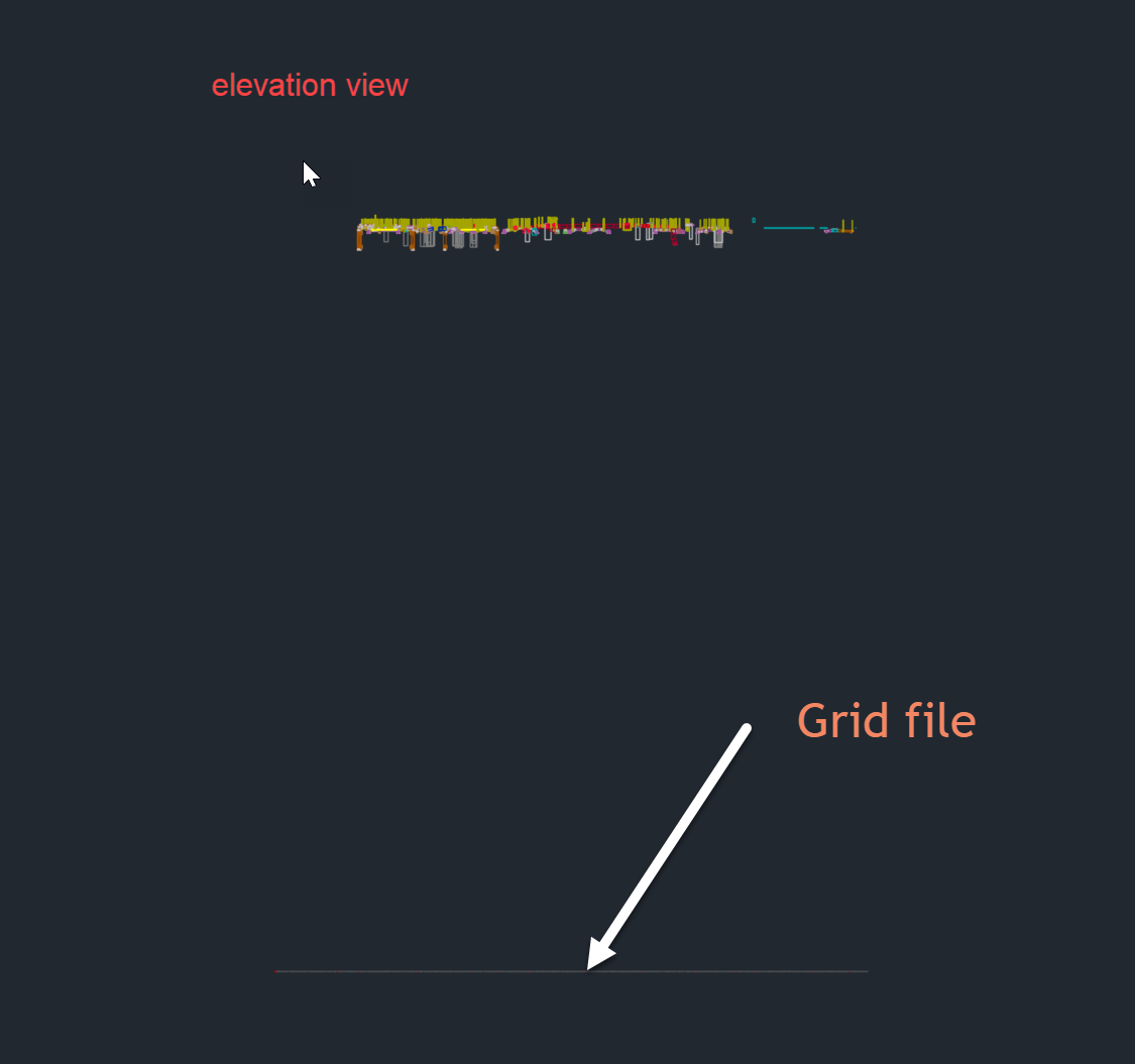

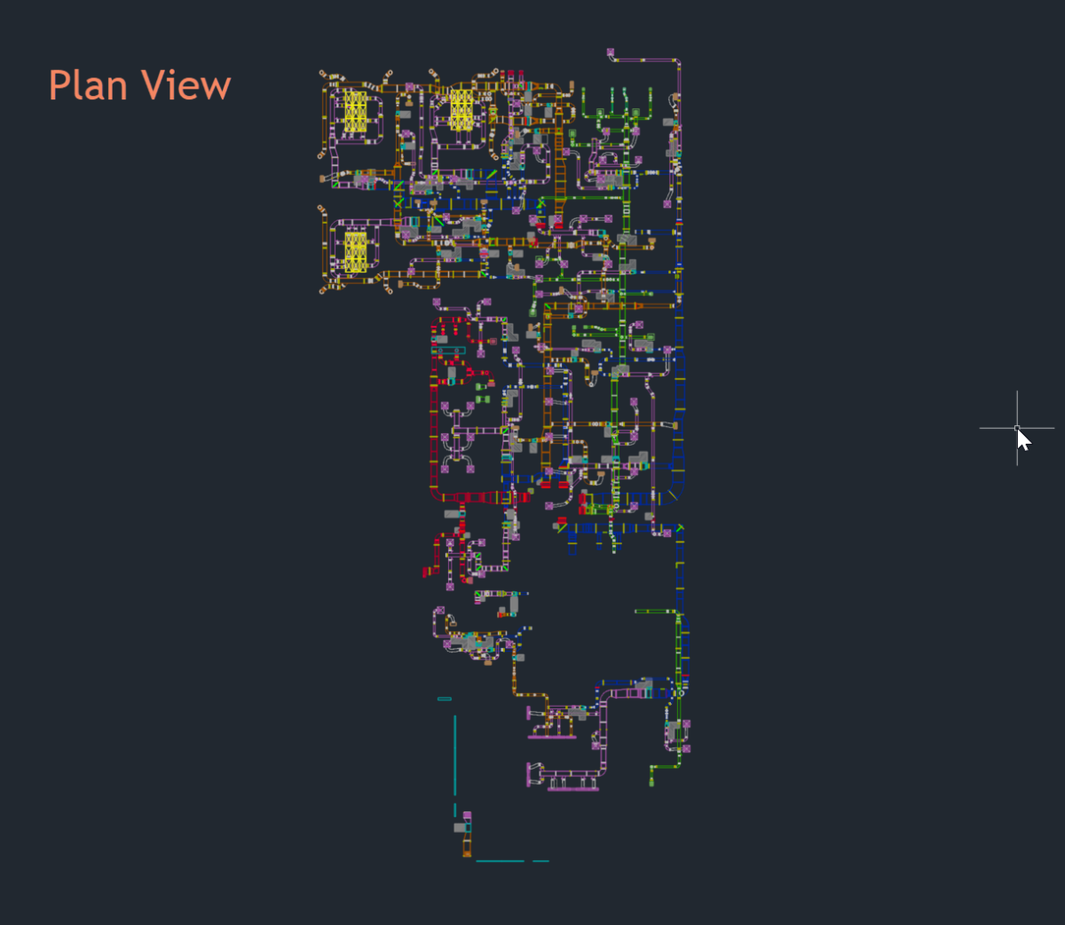

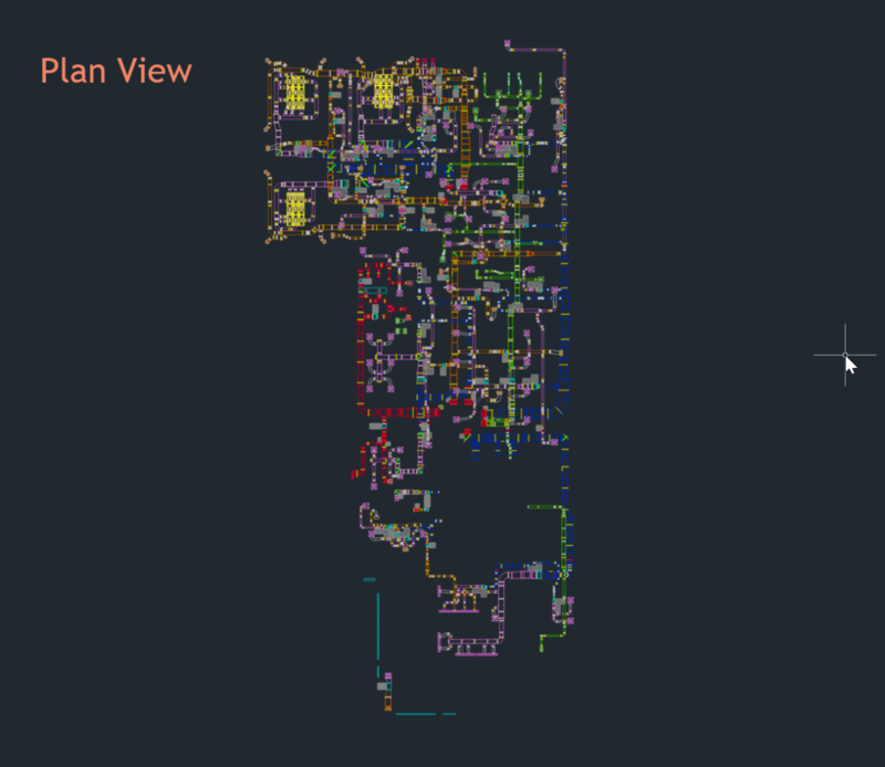

Hello - For some reason, I have lost the ability to see the 2D grid file that I have xref'd in.  I can see it when I look at the drawing from an elevation view, but when I look at it from a top view it is no longer visible.  Has anyone else had this problem?  Does anyone know how I can fix it?  Thanks in advance for your help!
If these are different view ports check to see if that layer has VP freeze on.
also check to see if perspective view is turned off
(setvar 'perspective 0)	    ; Turn off Perspective view in current viewport
