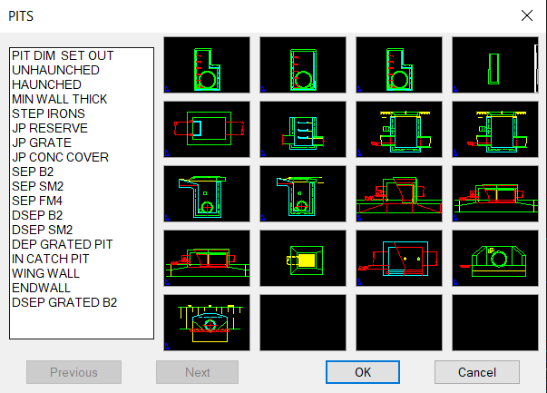

patmf Posted August 11, 2022 Author Posted August 11, 2022 This is the pdsym lisp. it's rather long and way over my head. right now I'm just trying to figure out how to make sure the doslib for 2013 gets loaded properly so the rest of his lisp routines work. (Especially this one as it saves hundreds of mouse-clicks each day and I would like to avoid another bought of tendonitis) I can't seem to get it to load through the appload dialogue PIDSYM.lsp Quote
BIGAL Posted August 11, 2022 Posted August 11, 2022 Found this "This section below is where the chosen symbol is inserted." Is it something like this, select a symbol. The code refers to slide images, a lot of sld files, and it is looking for pidsym.dcl, newsym.dcl, yesno,dcl do you have those also ? I think what is best is describe what the program does then we can get a better idea of what is missing. Quote
