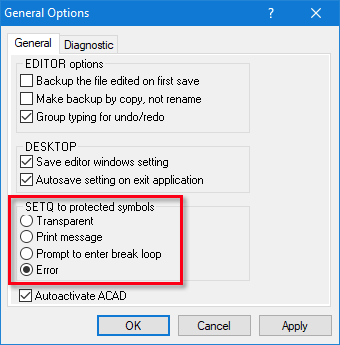

Sounds like you've redefined a protected symbol - I would suggest enabling this option within the VLIDE to alert you to such:
