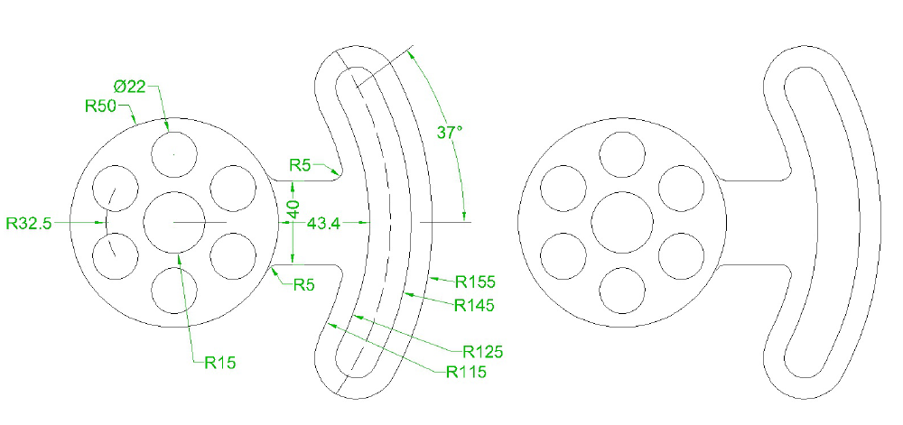

Hello,
Currently I am learning Autocad. I want to draw the drawing shown in the image attached herewith. Particularly, I can not figure out what would be the centre of arcs 115,125,145 & 155. I also can not understand that how to draw 37 degree dimension line. Some one please, help me as this is very important to me. I am using Autocad 2015.
At a glance it appears that the center point of all those arcs will be the center of the R50 and the R15 circles on the left.
Try using that center point and create circles of the appropriate radii to check.
Don't overthink it, keep moving forward, as the best way to LEARN is through making mistakes.  :beard:
The dimension line will be created as an ANGULAR DIMENSION.

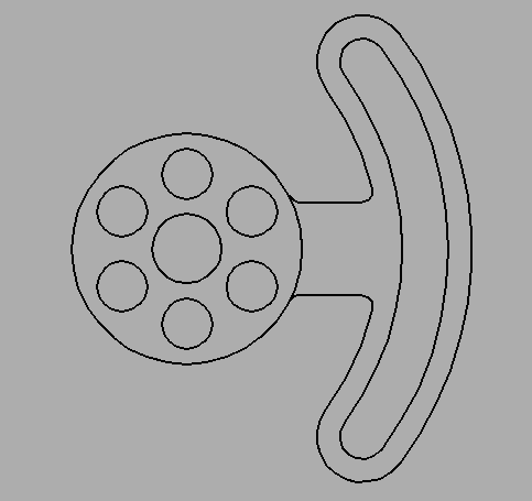

I wholeheartedly agree with the advice Dadgad has provided you.  Basically, the arcs are just concentric circles as you can see from the progression below...
  • Like 3
That is a highly informative visual, displaying one approach to the progression ReMark.

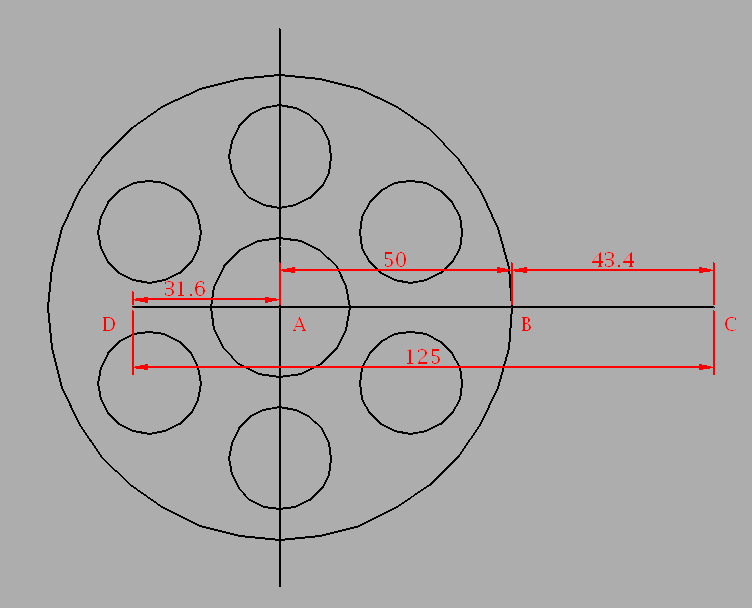

I have looked at it a different way. Consider the 50R circle (centre A). From the right hand edge (pt B), the first of the arcs is 43.4 from the edge of the circle (pt C). One knows that this arc has radius of 125, therefore its centre is 31.6 (pt D) to the left of A.
Having got this centre, the rest of the image can be drawn.
The 37­° line is not absolutely defined - is the line drawn from the centre A or the centre D? I have chosen pt D.
I find it easier for angled lines to first of all draw a horizontal line, and then rotate it.

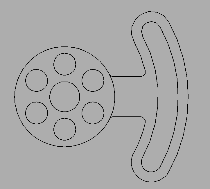

Having overlain the image, I am now convinced that the 37° passes through the centre of the 50R circle.
So here is my final attempt at drawing the image.
