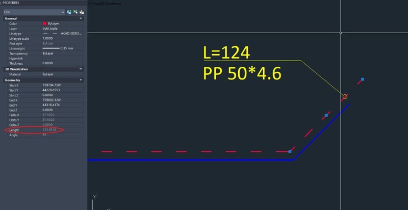

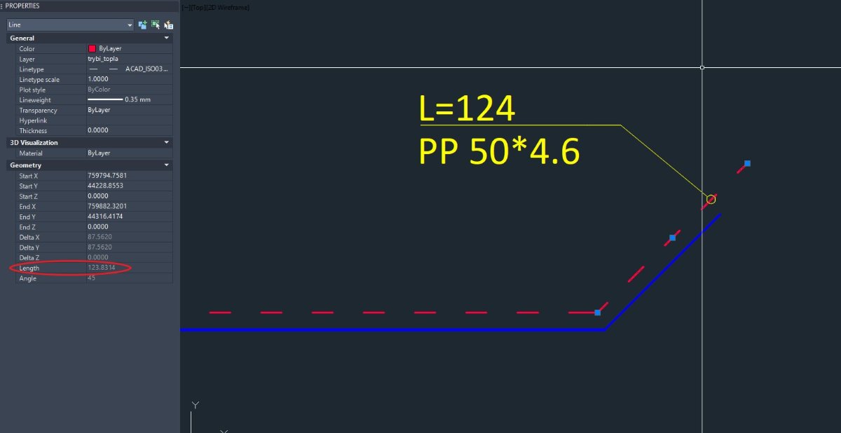

dimitarrr Posted August 3, 2022 Posted August 3, 2022 (defun c:DDD ( / a_lst b_lst obj len pt idx mtxt) (setq a_lst (list "PIPE" "PP 20*2.3" "PP 25*2.5" "PP 32*3.0" "PP 40*3.7" "PP 50*4.6" "PP 63*5.8" "1 1/2" "2" "3" "4" "5")) (setq b_lst (list "PP 20*2.3" "PP 25*2.5" "PP 32*3.0" "PP 40*3.7" "PP 50*4.6" "1 1#4" "1 1#2" "2" "3" "4" "5")) (setq obj (vlax-ename->vla-object (car (entsel "\nSelect Line : "))) len (rtos (vlax-get-property obj 'length) 2 0) ) (setq pt (mapcar '(lambda (x y) (/ (+ x y) 2.0)) (vlax-get obj 'startpoint) (vlax-get obj 'endpoint))) (setq idx (ah:butts 1 "v" a_lst)) (cond ( (setq mtxt (strcat "L=" len "\\P" (nth idx b_lst) )) (vl-position idx '(0 1 2 3)) ) ( (setq mtxt (strcat (substr "L=" len "\\P" (nth idx b_lst) 1 1) (substr (nth idx b_lst) 3) )) (vl-position idx '(5 6)) ) (t (setq mtxt (strcat "L=" len "\\P" (nth idx b_lst) ))) ) (command "_mleader" pt pause mtxt) ) I need help. I want to round numbers at the end. For example if length of line is 173 and its nearest to 175 the result to be 175. If length of line is 178 the result to be 180. Quote
Jamescalabut Posted August 3, 2022 Posted August 3, 2022 (setq num (getreal)) (if (< (rem num 5) 2.5) (setq num05 (- num (rem num 5))) (setq num05 (+ (- num (rem num 5)) 5))) Quote
mhupp Posted August 3, 2022 Posted August 3, 2022 (edited) This should do it. (setq obj (vlax-ename->vla-object (car (entsel "\nSelect Line : "))) len (rtos (LM:roundm (vlax-get-property obj 'length) 5) 2 0) ) ;; Round Multiple - Lee Mac ;; Rounds 'n' to the nearest multiple of 'm' (defun LM:roundm ( n m ) (* m (fix ((if (minusp n) - +) (/ n (float m)) 0.5))) ) --edit I'm getting nil for pt if your calculating midpoint try this. (setq pt (mapcar '/ (mapcar '+ (vlax-get obj 'startpoint) (vlax-get obj 'endpoint)) '(2 2))) Edited August 3, 2022 by mhupp 3 Quote
