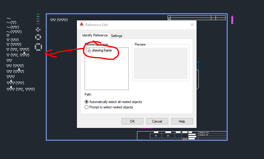

I need to print all drawings in folder.
In the drawing , the block name of drawing frame is same, so i want to find a lisp, software that able to print all drawing in folder with same block name.
Attached is for your test

No, it has many size, but all has same block name of drawing frame, we can use it to print. I am using softwarr Krst plot but it was not updated , so it did not work properly with latest autocad
