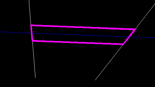

I hope I can explain properly what I would like to do.
I need to be able to click on an entity and draw a rectangle between two opposing entities but have the ends of the rectangle follow the angle of the two opposing entities.
For example if I have an entity and two apposing vertical/horizontal entities I would click the line, infinity line or sometimes polyline side then be prompted for the rectangle width and have it terminate at the two opposing entities and have the smaller sides at the angle of those entities.
I hope I'm making sense?
Thanks in advance!
Tom

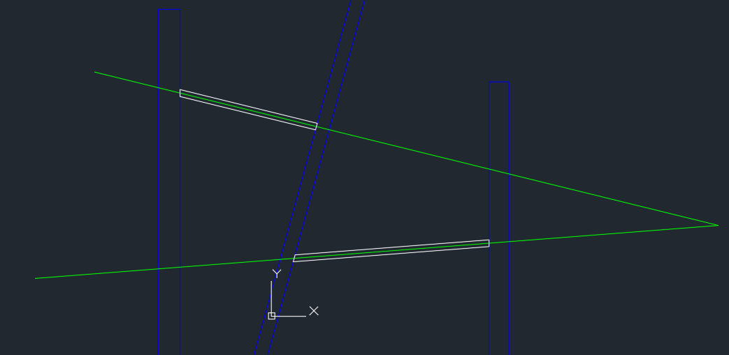

Select green line select 2 blues lines, use intersectwith to get intersecting points and work out the new 4 points. Look at image as an example. BIt short for time at moment.
@TemporaryCAD That worked nicely!
@BIGAL That is closer to what I'm trying to do. I'll look into the intersectwith function, I like the offset option. Then maybe use intersectwith from those offsets.

@Jamescalabut You are correct the wont always be vertical.
Your code is very close to what I'm trying to do, but I need to snap. sometimes it's an intersection sometimes it's an endpoint etc.
in @TemporaryCAD 's routine I can getpoint and I've been looking at how @BIGAL suggested using "intersectwith" with the offsets.
I just can't make heads or tails on a "projected" intersection.
But so far yours comes closest, if I could just snap 2 points, offset, then find intersections from that offset I think it would do the trick??

I combined the two and this code works!
I still have to select the "vertical" entities then pick the first and last points but I think I can make this work.....
I took out the snap overrides. will that have a significant or unpredictable result down the line? but right now it seems to get me there.
Also, this routine offsets from a centerline, which is exactly what I need. But I also need one to offset to one side of the selected points.
I'm going to try to modify to do that too as a separate routine....any suggestions?
@Jamescalabut after working with it for a little bit, I noticed that it throws a dividing by zero error for parallel lines?
Also, It works well if the new rectangle end points are ON the opposing entities. But if I select the ENDS of the entity it doesn't follow correctly?
I tried a couple of things but broke it....lol
Here is the newest modified routine (not broken), I added a polyline entity instead of separate lines. Credit for the polyline routine goes to another member, just can't find the thread.

Try this one. First, select the "boundary" rectangle, then specify offset distance, and finally select the "green" line at where you want the shape to be created:

@Jamescalabut If I were to create a program, I'd rather have the code do all the complex calculations and have the command made as user-friendly as possible. The less you prompt the user for inputs, the better. But for learning purposes, any progress is definitely worth every effort you put
Just as you said, IntersectWith finds out ALL intersection points of a line, and peforming the calculations are quite hard. If you were already prompting the user for the point instead of the curve, you've basically skipped to Step 5 of my code. Another approach you can do is: You already have p1 and p3. If you have (for example p5 which represents the same calculation from p2), then you can use the inters function to calculate the intersecting point of 4 points (like Step 6 of my code), being p3, p5, p1, and (polar p1 <the angle of the curve at p1> <any_length>). Though still, no matter what approach is taken, the process still needs to be repeated four times to get the four points required to draw the curve and this.
I've tried adjusting some parts of your code to make it simpler. It should still function the same way as your original code:
(defun c:try2( / alpha ent1 ent2 int1 int2 int3 int4 k1 k2 line1 line2 line3 oldsnap p1 p2 vlaobject-line1 vlaobject-line2 vlaobject-line3 width)
    (vl-load-com)
    (setq oldsnap (getvar "osmode"))
    (setq p1 (getpoint "point on the first entity: "))
    (setq p2 (getpoint p1 "point on the second entity: "))      ;; Add p1 to create a ribbon line to the first point when prompting the second point
    (setq ent1 (vlax-ename->vla-object (car (nentselp p1))))    ;; Use nentselp for automatic selection of the polyline using a picked point
    (setq ent2 (vlax-ename->vla-object (car (nentselp p2))))    ;; Use nentselp for automatic selection of the polyline using a picked point
    (setq alpha (angle p1 p2))
    (setq width (getdist "\nWidth: "))  ;; Changed to getdist for better flexibility of distance input.
    (setvar "osmode" 0)
    (setq line1 (entmakex (list '(0 . "LINE") (cons 10 p1) (cons 11 p2) '(210 0.0 0.0 1.0))))   ;; Use 'entmakex' to return the generated entity instead of entlast.
    (setq vlaobject-line1 (vlax-ename->vla-object line1))
    (setq vlaobject-line2 (car (vlax-safearray->list (vlax-variant-value (vla-Offset vlaobject-line1 (/ width 2))))))      ;; Use Vla-Offset to get your offset line by distance
    (setq vlaobject-line3 (car (vlax-safearray->list (vlax-variant-value (vla-Offset vlaobject-line1 (/ width -2))))))     ;; Use Vla-Offset to get your offset line by distance
    (mapcar     ;; You can use mapcar instead... I guess
        '(lambda (a / k1 k2 v)
            (set (car a) (vlax-safearray->list (vlax-variant-value (vla-IntersectWith (cadr a) (caddr a) acExtendboth))))
            (setq v (eval (car a)))
            (setq k1 (list (car v) (cadr v) (caddr v)))
            (setq k2 (list (caddr (reverse v)) (cadr (reverse v)) (car (reverse v))))
            (if (> (distance (cadddr a) k1) (distance (cadddr a) k2)) (set (car a) k2) (set (car a) k1))
        (list
            (list 'int1 ent1 vlaobject-line2 p1)
            (list 'int2 ent2 vlaobject-line2 p2)
            (list 'int3 ent1 vlaobject-line3 p1)
            (list 'int4 ent2 vlaobject-line3 p2)
    (command "_line" int1 int2 p2 int4 int3 p1 int1 "")
    (vla-delete vlaobject-line1) (vla-delete vlaobject-line2) (vla-delete vlaobject-line3)
    (setvar "osmode" oldsnap)   ;; Set snap variable back.
@Jonathan Handojo That works Very nicely! very simple to use.
One thing I like about this site is how helpful everyone is. Like you said, any progress is worth it.
I've learned a lot more by studying other peoples code, some of these routines are pretty involved!
Can you modify that routine to also offset to one side instead of centerline?
When I click the end of the two entities, the two picked points become one side of the rectangle, the offset could then intersect with the two entities and create my rectangle.
I need both routines, I draw a lot of designs with center supports and supports at the ends.
At the ends, the supports are always captured between the two entities.
Thanks Again
@Tom Matson Maybe give this one a go. Same process as the previous command, but after clicking on the centerline, simply move your mouse to either side of the curve, or have your cursor near the curve for the center, and click to place:

Thank you everyone,
This is the second routine I cobbled together from all the suggestions.
It is for an offset rectangle and it works only one direction,(L to R at the bottom of the entities and R to L at the top) which I'm ok with.
My question now is about the snaps....
For this routine I only need the end of the entities, that I turn on.
I thought it stored the current snap settings and then restores them but that doesn't work.
Also, if I'm zoomed out too far things go haywire....lol
Any Ideas?
;; draws a polyline
(defun drawLWPoly (lst cls ang bl tl br tr);
 (entmakex (append (list (cons 0 "LWPOLYLINE")
                         (cons 100 "AcDbEntity")
                         (cons 100 "AcDbPolyline")
                         (cons 90 (length lst))
                         (cons 70 cls))
                   (mapcar (function (lambda (p) (cons 10 p))) lst))))
;PCRTS For Perimeter Click Rect To Shape
(defun c:PCRTS( / alpha ent1 ent2 int1 int2 int3 int4 k1 k2 line1 line2 line3 oldsnap p1 p2 vlaobject-line1 vlaobject-line2 vlaobject-line3 width)
    (vl-load-com)
    (while
    (setvar "osmode" 1 )
    ;(setq width (getdist "\nWidth: "))  ;; Changed to getdist for better flexibility of distance input.
    ;(setq vlaobject-line2 (car (vlax-safearray->list (vlax-variant-value (vla-Offset vlaobject-line1 (/ width 2))))))      ;; Use Vla-Offset to get your offset line by distance
    (setq vlaobject-line2 (car (vlax-safearray->list (vlax-variant-value (vla-Offset vlaobject-line1  width )))))      ;; Use Vla-Offset to get your offset line by distance
    ;(setq vlaobject-line3 (car (vlax-safearray->list (vlax-variant-value (vla-Offset vlaobject-line1 (/ width -2))))))     ;; Use Vla-Offset to get your offset line by distance
        (list
            ;(list 'int3 ent1 vlaobject-line3 p1)
            ;(list 'int4 ent2 vlaobject-line3 p2)
            (list 'int3 ent1 vlaobject-line1 p1)
            (list 'int4 ent2 vlaobject-line1 p2)
    ;(command "_line" int1 int2 p2 int4 int3 p1 int1 "")
    ;(drawLWPoly (list end3 end4 end6 end5) 1)
    (drawLWPoly (list int1 int2 int4 int3) 1)
    (vla-delete vlaobject-line1) (vla-delete vlaobject-line2) ;(vla-delete vlaobject-line3)
