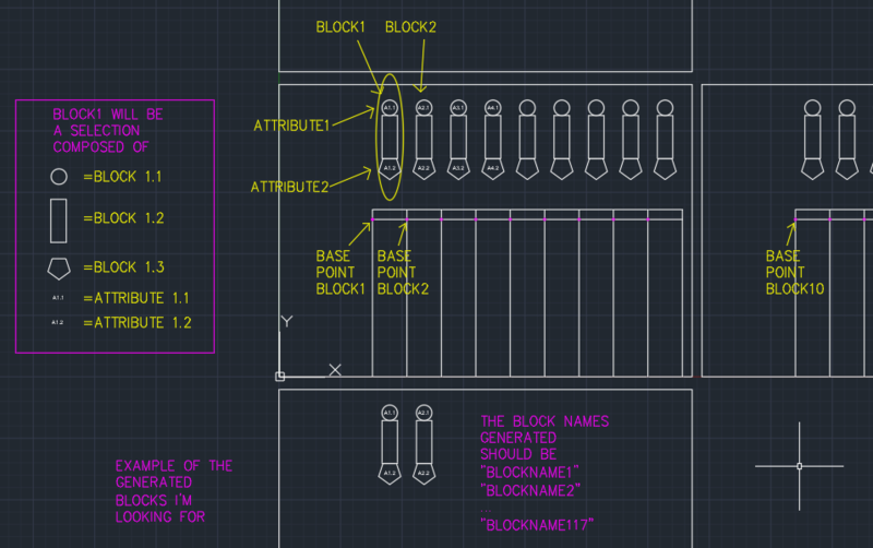

Hi everyone I'm new to lisp.
I'm using Quick Block by Tharwat and works great but I'm trying to automate it more.
The pink circles are the base point of each individual block at some point at block 10 the distance between base points change (this doesn't really matter I can make them all equal distance if needed). There are a total 117 blocks each row and I have many rows but a row is just fine since i need to change the block name each row and start to create blocks counting from 1 to 117 again.
So i need to choose the base point and has to be at those exactly magenta coordinates at bottom left of each individual block
I need it to be fully automated from block 1 to 117 after giving the first block instruction is that possible?

I am confused yes make a block from objects as you have already, using Array and  the Last object picking the spacing of the array and a start point calculated as a offset from point 1.
There are a total 117 blocks each row where are the 117 can not see that ?
I think he wants them named different  like "firstrow1 - firstrow117"  and their are different spaces between.
Not as automatic but http://www.lee-mac.com/copyblock.html
Was trying to come up with copy and then rename like this post
https://www.cadtutor.net/forum/topic/75385-increment-number/page/2/
but its not as easy to do with entmod because you cant change the block names that way.
probably could copy and explode then rejoin with new name but that seems messy.
That way you don't have to keep selecting whats in each block and then the base point. You would just have to pick the new base point.

I think we need more info.
Re new block name if copy the entities in a selection set to somewhere 0,0 reselect as a temp selection set copy again make block at 0,0 etc should be able to repeat numerous times and have different block names.
Not the best code, but it gets the job done.

Didn't see your last post till I posted mine. make the first block for the row then use CB to copy and rename for the other 116. they will all have the default attribute. so use ATTOUT & ATTIN to update them

I don't see why you would just not make a new block of circle, rectang, ploygon with 2 attributes it is very easy to copy and increase the attribute values. A1.1 A1.2 and so on.
It would just ask for prefix and start number, next group B1, next group C1.
If happy me or some one here will provide some code to add numbers when copying.
