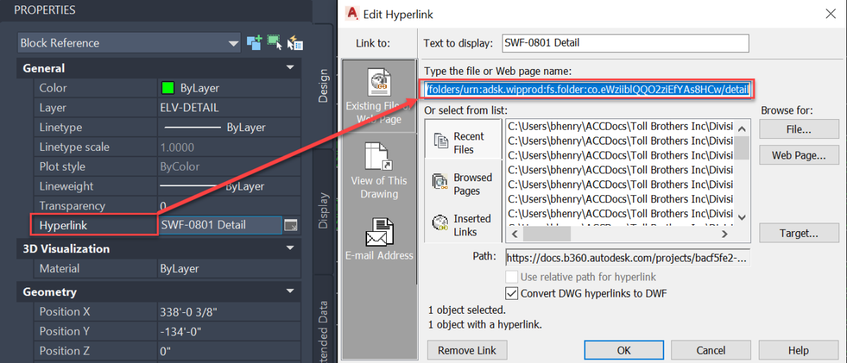

So, the plot thickens. Is there a way to include the hyperlink info (external hyperlink in properties with block selected and not within the block)? I found some code shown below on a forum page that will produce a list of all of the hyperlinks of selected blocks, but I need this to maintain the previous list functions of removing duplicates, but append the hyperlink of that block to the list.
; https://www.cadtutor.net/forum/topic/63138-extract-hyperlink-from-block/
; extract hyperlinks outside of block
(defun c:ExHyp (/ )
(vl-load-com)

One of your blocks doesn't have a link and held me up for 30 mins tying to fig out why it kept giving me an error.

        (setq hyprlnk (vlax-get-property blk 'Hyperlinks))
        (if (> (vlax-get-property hyprlnk 'Count) 0)
            (setq hyprlnk (vla-item hyprlnk 0))
            (setq link (vlax-get-property hyprlnk 'URL))
          (setq link "Link Not Found")
        (or (assoc x lst) (setq lst (cons (cons x link) lst)))
      (setq lst (vl-sort lst '(lambda (a b) (< (car a) (car b))))
            file (open (strcat (getvar 'DWGPREFIX) "_Details.csv") "w")
      (foreach itm lst
        (write-line (strcat (car itm) " - " (cdr itm)) file)
      (close file)
      (startapp "C:/Program Files (x86)/Microsoft Office/root/Office16/EXCEL.EXE" (strcat (getvar 'DWGPREFIX) "_Details.csv"))
  (princ "\nSaved Details CSV File!")
