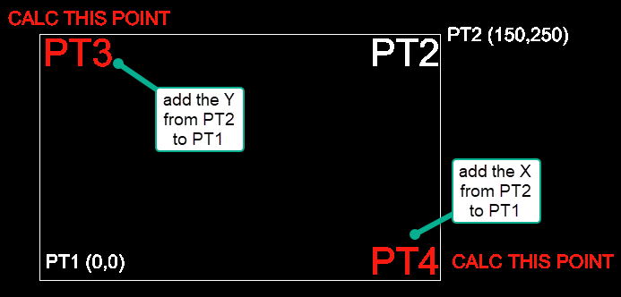

What I mean is, can you do something like this:
;create new point from x and y offset of point.
(setq off1 (pt1 + (12,12))

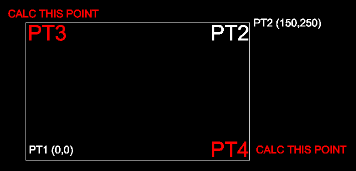

The rectangle example is:
IE:
(setq pt1 '(0 0)
      pt2 '(150 250)
      pt3 (mapcar '+ (list 0 (cadr pt2)))
      pt4 (mapcar '+ (list (car pt2) 0))
      ;; or less 'fancy'
      pt3 (list (car pt1) (+ (cadr pt1) (cadr pt2)))
      pt4 (list (+ (car pt1) (car pt2)) (cadr pt1))

9 minutes ago, ronjonp said:
IE:
(setq pt1 '(0 0)
      pt2 '(150 250)
      ;; or less 'fancy'
Awesome thanks. I agree mapcar and car etc, does look like the cleanest solution.
