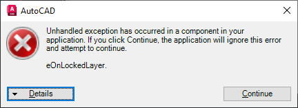

I want to be able to copy a locked layer to a new one with the COPYTOLAYER command.
I've tried to get around this by unlocking the layers before, then after the COPYTOLAYER command.
This will throw an error like so when I try to copy a locked layer:
