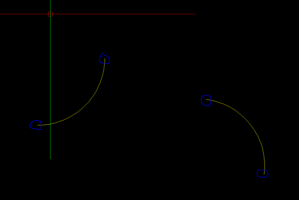

someone help me to get the start point and end point of any arc
is there any lsp routine for this?

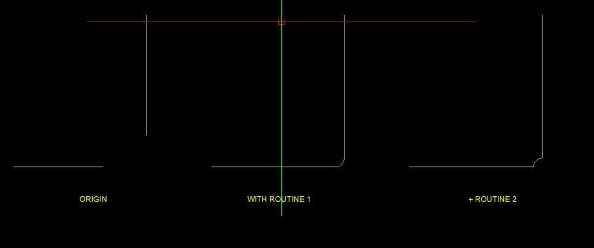

I need to learn how to get those points, I need it for another more complex routine
what I need is to touch the arc and make a mirror with axis of symmetry in the initial and final points of that arc
Extremely quick and dirty.  The DXF Reference manual is your friend...

There are also the curve-functions which you can feed an ename to:
VLAX-CURVE-GETSTARTPOINT
VLAX-CURVE-GETENDPOINT
(if (setq e (car (entsel)))
  (progn (setq sp (vlax-curve-getstartpoint e)) (setq ep (vlax-curve-getendpoint e)))

 now I have 2 routines that do it but separated and I don't know how to join them  :(
1.lsp 2.lsp test.dwg
